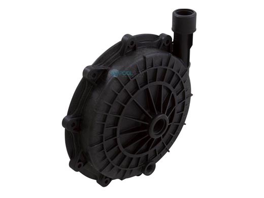

The pump volute should be replaceable if parts are available.
Maybe this?
The model is a First Choice FCH38104301PDA. (It also has Century sticker but none of those markings bring up much in searches: CET51ABM and C48D62A79.) Searches for FCH38104301PDA parts often leads to Waterway 3/4 HP Booster Pump Parts and the Volute (thanks for helping me with this part name) is part #315-8300. First Choice website is here: Universal Booster Pump | First Choice Pool Product. This booster pump looks just like mine but it has a different part number. The website is not very helpful as far as replacement parts, manuals, warranties go. I strongly expect it is out of warranty.
I guess I could call PoolZoom to see if First Choice and Waterway parts are the same: Waterway 3/4 HP Booster Pump Parts. Actually, lots of places including Leslie's, Amazon, PoolSupplyUnlimited sell the #315-8300 Volute. I would want a store that could recommend the correct seal kit and o-rings as well, and any installation tips.

Thanks everyone for the help. The strong agreement on the part number is encouraging. The waterway manual will be helpful too. If I drive a few extra miles to one of the better Leslie's, I can double-check parts for seal kit/o-rings and use my $45 in rewards. If they cannot help, I'll try Pool Supply Unlimited. Thanks again.
