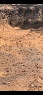

We have roots growing upwards out of the ground - a few are 1/4" to 3/4" in diameter.
If I cut the roots below ground level, is there a risk the roots will eventually puncture the gorilla pad and pool liner ?
If there is a risk, any tips on how to correct this issue ?
Thanks !

You will need to treat the area where the pool will be with nut grass killer. Do you know where the roots are coming from? Is there another layer of hard packed soil under the sand?
It appears that some of the roots are coming from a muscadine grape vine the neighbors to the back of our property have along their fence. There are a lot of trees behind and to the side of our property, which correlates to where the roots are located in the dug out area - mostly pine trees and sweetgum trees.
I was thinking of putting down two gorilla pads to lower the risk of the roots returning or maybe some foam pads if that is the better option to protect the liner from possible future root growth ? I am not sure what to do about the roots growing out of the side walls of dirt - is it enough to trim them even with the soil or should we put something against the walls to detour the roots ?
Once we smoothed out the area, it is firm to walk on - do not leave footprints like on a beach. . We wet it down and the sand is clay like in consistency and color . I have a ladder set up in the dug out area to climb in and out of the area and it does not sink down at all.
I would still put down nutgrass killer, then put down gorilla pads. Muscadine roots are not super aggressive but there may be other roots that are and some of them can bust through concrete!
Thank you for the information. We have ran into another issue while leveling, the soil is a lot sandier than we thought especially around the diameter where the pool supports would be. We dug a small hole in one area 2 feet deep and the sand was the same consistency. We are thinking our only option is to put in a concrete pad ? Any thoughts would be greatly appreciated !
Here's what you can do. Get some pressure treated lumber and build a box to set the pool in. It will need to be about 8-12" deep, and big enough that there is at least a foot of space between the box wall and the pool. For example if you have a 30' pool you build a box big enough to hold a 31' circle. You don't want the pool or the blocks to touch the edge of the box. Here are all the steps:
  • Build a box with pressure treated wood approximately 8-12" deep
  • Fill the box with layers of decomposed granite or crusher stone. Lay down a 1" lift and compact it well with a plate compactor or weighted roller. Keep building layers and level them as you go so you are building a stable, level surface. Stop adding layers when you are 2" from the top of your box.
  • Lay out where your paver blocks need to go to support the uprights
  • Inset the paver blocks so the top of the paver is flush with the ground. Once the first paver is set, use it as a reference point to install the other blocks in a star pattern and make sure they are all level with each other before completing the installation of the pool.
This should give you a firm, stable base to build on. If you choose you can use foam coves or the same sand on site to build coves around the inside of the pool.
