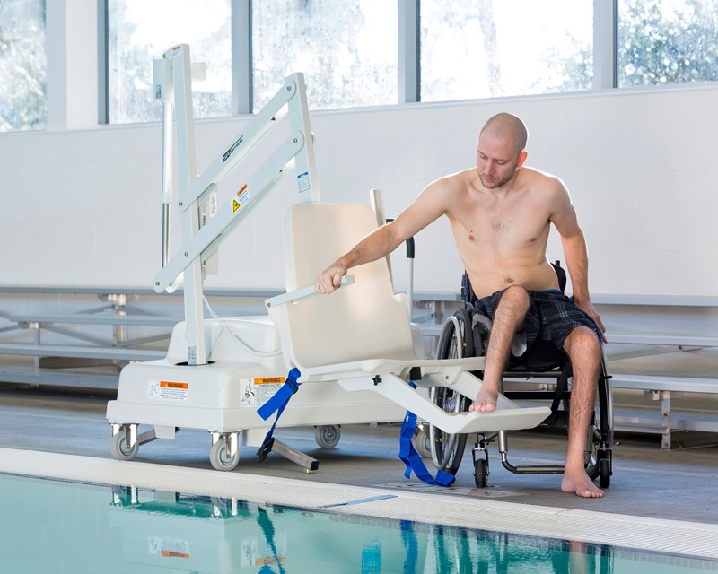

You can get a lift if you need this.
Reactions: anthonypool89
lol...yep...that'd work!! Fun trying to get the cover over that..especially with someone in the chair. "Where the heck is she anyway? Haven't seen her since...wait...I have an idea....check under that cover..."
