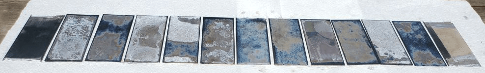

When I took apart my old cell, scale most certainly collects on one side of the plates vs the other so there is definitely a bias although I did not take note of which was the anode and which was the cathode but I should be able to do that for the next cell.
One side clearly has more scale than the other on many of the plates.
Any type of scale can reduce the performance of the cell.
I think that that is a well established fact.
Scale prevents water from contacting the plates and creates a barrier (insulation) to the flow of electrons.
You can get calcium carbonate and/or calcium phosphate scale as well as other types of scale.
The reported level for phosphate is less than 1 ppm, so probably not a high risk of scale.
Scale is usually visible and the cell can certainly be checked to make sure that it is clean.
If, and only if, the cell is scaled, then clean the cell as needed.
Calcium carbonate dissolves with acid.
Calcium phosphate does not dissolve so easily.

But that reaction would be close to the anode rather than the cathode because that is where the Cl2 is. Flow near walls is laminar so does not tend to mix easily with flow away from the wall. So the two reactions may actually be separated for some time with the PH on the cathode increased.
Most cells are self cleaning and reverse polarity every cycle, so there is no permanent anode or cathode.
Each side of the plate should spend roughly the same amount of time being an anode and being a cathode.
I knew better. Completely forgot about that. But then it brings up new questions about the asymmetry in scale. probably has to do with the fact that the outer 2 plates and the inner plate are the only ones with voltage.

This is exactly the line of reasoning I outlined earlier and why I though the phosphates could impact performance as well as cell lifetime. And yes, for the OP, I agree, probably not an issue for the reported PH/TA/CH. It would require something around 5 ppm to start to precipitate. However, with the reported CH of 375, PH of 9.5 and water temp of 90F, it is possible even with 1 ppm. We still don't know for sure if the cathode plate does not have very high PH for the reasons I explained above. One could possibly estimate the PH rise if the flows remained separated for the entire length of the cell based upon flow rate and current. The only issue is taking into account all of the side reactions.
I get scale on my SWG even when CSI of the main water body is less than zero so I am fairly confident the PH near the plates must be higher than the rest of the water. Just not easily measured.
