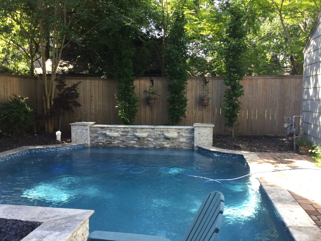

Here are pics with the Sweetgums in the back. This was taken at about 10:15 -pool still shady.

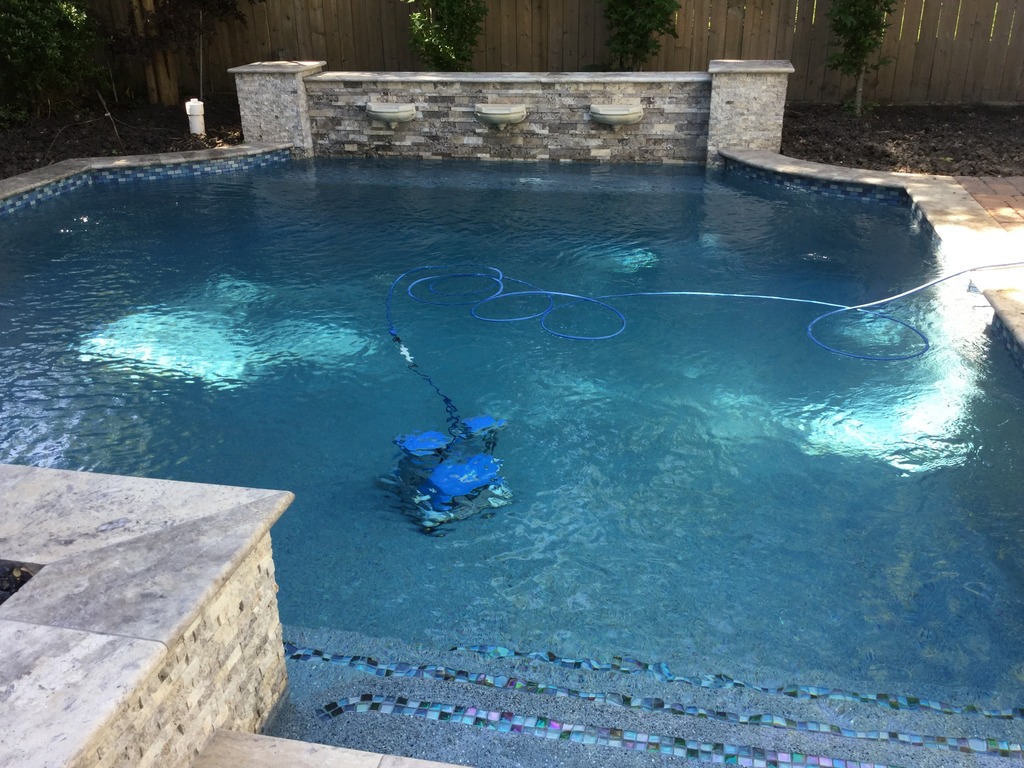

Dolphin in action.

Suz, I'll let you know how the Sweetgums work out. They are supposed to turn red in the fall and not have any or just a few of the sweet gum balls that drop.
And yesterday, the robot finished cleaning the pool about 2 hrs before the rains hit!

Marla do you love the scuppers? How do they sound when they are on?
