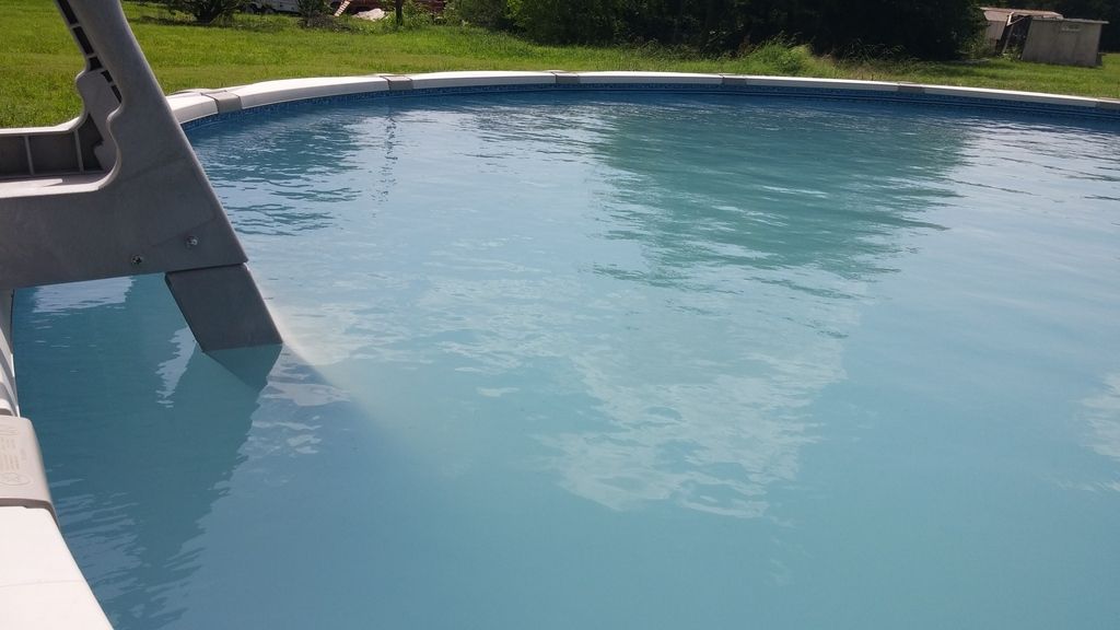

Ok Kim you asked for a picture so I am posting one this afternoon. After being gone all day I came home and my FC has dropped to about 10.5 so I am going to raise it to about 15. My CYA is at 40 as well.
I also added a box of 20 mule borax to bring my PH up a little because it was ridding just under 7.2 this afternoon. During the day, my pool gets FULL sun. The pool is looking a little better today. ISH. maybe. :)
Looks like it's just very cloudy n will come down to a filtering issue once the algae is completely dead.
