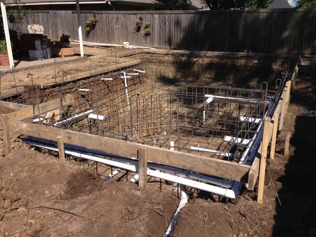

    Day one has arrived. Today's construction.

  18. Back To Top    #18
    Re: New Build....Nederland, TX
    Day 2 complete. Gunite Monday.

    And there goes the yard! Can't wait to see it completed!
  20. Back To Top    #20
    Day 3 is complete
