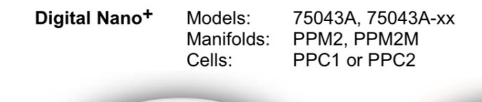

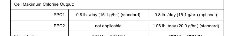

Your cell puts out 1.56 lbs. per day
Hit the gear ⚙️ icon in. Poolmath & add that info then hit the ✔️
You can then easily use effects of adding in the hamburger menu to see the estimated fc output based on your % & run time.
You can also log your current settings by hitting the + & selecting swg from the chemicals list so it shows up like this
Add your cell type to your signature.
