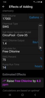

Keep in mind also that manufacturer claims are sometimes overstated. That aside, Pool Math says running 14 hours at 75% will add 4.3 ppm of FC daily. As Reggie said, that's probably close to your daily loss during swim season. I would do an Overnight Chlorine Loss Test just to rule out algae. If something is brewing, catching quick will save time and money. Here is what your SWG's FC production looks like in the "Effects of Adding" section of Pool Math:
+1 to the OCLT.
You need to prove your loss (or lack thereof) before you can troubleshoot insufficient gains.
