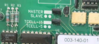

Can you turn off the power and then remove the display board and show a picture of the main board.
Reinstall the display board and then turn on the power and see if it is better.

My sincere apologies for the late reply. I didn't realize you had responded. Took off the display PCB reinstalled it and turned it on. I'm getting a low salt reading and inspect cell reading. The cell is only a couple of months old. The temperature of the water via the swg is 72. I'm told that at a certain water temperature the swc will no longer generate chlorine. Is 72 about the time/temp that the swc shuts down?

1. Its a Hayward Swim Pure Plus. Similar to the AquaRite in terms of how some information is collected using diag but unsure of how the two compare on a 1 to 1 relationship
Readings after auto to off:
a. pool temp, 72
b. cell voltage, 31.9
c. cell current, 0.00
d. desired output, 100p
e. instant salinity, - 0
f. product name, AL - 5
g. software revision, r 1.40
h. default salt display, 2000
2.
Readings after back to auto:
a. pool temp, 72
b. cell voltage, 24.3
c. cell current, 4.05
e. instant salinity, - 1800
f. product name, AL -5
3.
Readings after off for 1 min & back to auto:
a. pool temp, 72
b. cell voltage, 32.1
c. cell current, 4.08
d. desired output, 99p
e. instant salinity, - 1600
4. I'm clear on how reversing polarity could he helpful. I'm unsure as to whether my unit does that so there was no mention in the owners manual. However it did say that "there is a self cleaning incorporated into the electronic controls logic" however it doesn't mention how to manually engage that self cleaning.
5. Done
6. SWG Cell 3E20261 SWG Control Box 5A0605-1012288
7. Actual Salinity measured by Leslies approx. every 3 weeks. Salt readings over time starting with most recent 3003, 2998, 2934, 2857
8. T-Cell-15
9. In my unit it is my understanding that because of the revision number mentioned above r 1.40, this unit is not one of the ones where you can set the T-CELL size. I did recently replace the T-CELL by taking the old one into Leslies and they sold me this new one.
The cycle is 120 minutes.
After the cell turns off and then back on, the polarity reverses.
For your circuit board, you can have a T-5 or a T-15.
Your jumper is set to T-15.
The numbers look correct.
So, the cell is smaller than a T-15 or the salinity is lower than you think.
Does the cell actually say T-15 on the label?
I recommend the K-1766 salt test kit.
