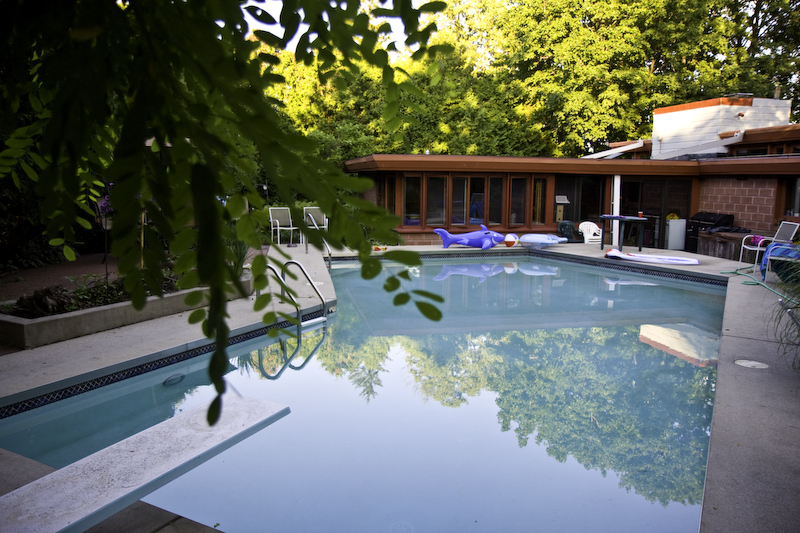

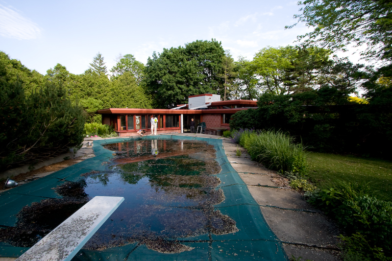

well after a great first season I'm already looking forward to the next! I'm so thankful for all the help on here and getting me up and running with my first pool! Below are a few photos later in the season.
We went form this:
To This:
