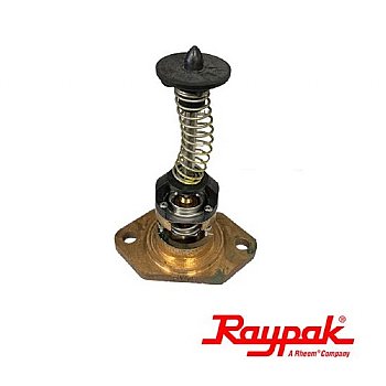

Hello
raypack model heater is 337A with versabrass header
any idea what part number the unitherm is?
cant seen to find it
the other ones i find are bigger in size
this particular one is smaller in size and screwed in all 4s

NOTE: The Unitherm Governor and Bypass Valve Assyare not individually replaced components on ASME units.
If either needs to be replaced, the entire UG/Bypass assy must be replaced.
The "yellow" spring is used on models 207A, 267A.
The "green" spring is used on models 337A, 407A.

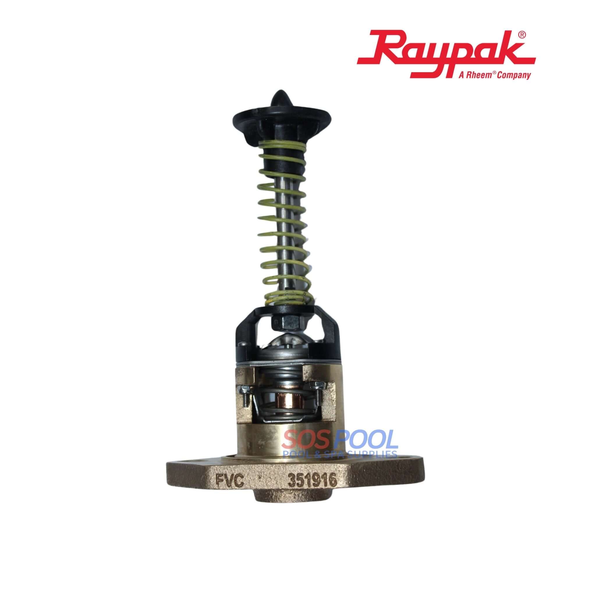

The patented Unitherm Governor is a thermostatic mixing valve specifically designed to maintain constant heater internal temperature between105°F (41°C) and 115°F (46°C) despite continually changing flow rates from the filter and changing pool temperatures.
This narrow range is needed to prevent damaging condensation on the burners which will occur if the heater runs for any length of time below100°F (38°C).
It is also needed to inhibit scale formation in the tubes by maintaining temperatures well below accelerated scaling temperatures.

Looks like part number 018758F is probably correct.
It is a combination Internal Bypass and Unitherm Governor.
NOTE: The U.G. on ASME models (bronze headers) can only be replaced by replacing the entire Unitherm Governor/Bypass Valve Assembly.
U.G./Bypass Assembly (Units manufactured from 12/2019).
When was the heater made?
