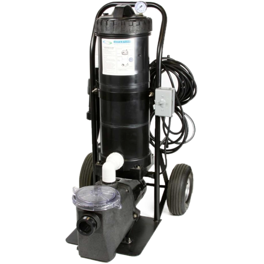

Basically I want to use an old pump to vac out the pool when I have to vac to waste. Is that a bad idea?
Long story short when we redid the plumbing/liner/etc they forgot to add things like a vac port for us to connect to and it was “too late to add” when we asked where it was. After a few other problems we have a new company that opens and closes the pool. They come after opening to do a “Power Vac” but it can be a pain. If the pool is not 100% clear they will not do it. I am talking we had a small cloud in the middle of the deep end but could see the bottom. Came home to a dirty pool and a $45 service fee for showing up but not doing the vac because the pool was cloudy. They also charge over $300 to vac out all the dead stuff a week or two after opening.
Basically I just want to take my old single speed Hayward pump, connect a vac hose, and blow it all down the front lawn. The investment would be small; new hoses, vac head, couple of fittings, and a new power chord for the pump (old pool company stools pump from garage and returned without cord after we asked why they took things from garage). Right now I just us a robot weekly and brush 2-3 time a week. The reason I don’t want to use the system is that both skimmers are going to be going to waste when I use the vac and it drains quickly. Even over filling and doing it I will be below the skimmers in no time, have to stop, refill, and start again.
So is it a bad idea to make an old pump a power vac when I need to vac to waste?

As to your pump idea, they sell them commercially, and mount them to dollies...so why not? Have at it...love to see the results!

Making a frankenvacpump was the idea. Boredom and wanting to see if it was possible. Also not wanting to get rid of a working pump.
