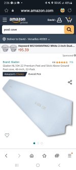

What is everyone's thoughts on the attached cove and pad for the walls? Had some co workers recommended.

Our last pool and our current pool just had/has the sand cove and no wall foam. I never said to myself I wish I had the foam but then again I don't know what I may be missing! ;) 🤣

I have had both.
I had foam cove and wall foam in my last pool
I just used foam cove in my new pool
In my experience, the foam cove is awesome. It makes it very easy to get a consistent shape, and maintain that shape. I think it makes for a really nice install.
Wall foam on the other hand, not so much. I did not notice any sort of heat retention improvements or reduction in external wall sweating (condensation).
It does make the walls minimally "cushy", but I am not in the habit of crashing into my walls, so I don't see the benefit.
Also, foam cove makes the installation a lot easier. Wall foam is a bit of a PIA. It gets wrinkly if you are not careful, and then sand gets stuck to the glue, etc. It's not hard to do, but it can be fussy.
My installer does not charge extra labor for foam cove. If I used wall foam, I think he charged $100 extra to install it.
Also, I used a pad for the first time on this new pool, but I have not been in it yet (I closed the pool the day it was installed). When I changed the liner in my old pool, I spent a *lot* of time getting the sand bottom perfect - leveling, compacting, removing ridges, compacting again, etc. I also took a lot of care putting in the liner to not disturb the sand. It was great, for about 2 weeks, and then it started to develop divots from people's heels. It made vacuuming a pain. I am hoping the pad helps with it.
I like the idea of the foam cove- wish i had it personally & plan to use it next time.
Wall foam - not so much for the reasons phonedave mentioned. Spend the money on something else you need/ prefer to have like a test kit refill 😁

I like the wall foam as cheap insurance. It will give the liner a slightly better chance of not puncturing with dogs, kids or flying branches during storms.
It's R value is a joke so it only insulates on a technicality. Yes it does, but also no. :ROFLMAO:

On the puncture thing I am not convinced that it doesn’t make the potential worse since there is more give. But what do I know, my pool has a bb hole in it. 🤣🤣Not sure if wall foam would have helped there or not?
