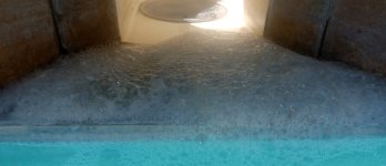

I spritzed all of the tiles without scrubbing, which took hours but they eventually dissolved all the "scale" on the lower half of each tile (I don't know what the very white powder is on the top half of the tile though), but the scale was so thick on the skimmer that I had to pour undiluted HASA muriatic acid on the flats which bubbled away the scale without any scrubbing needed.
