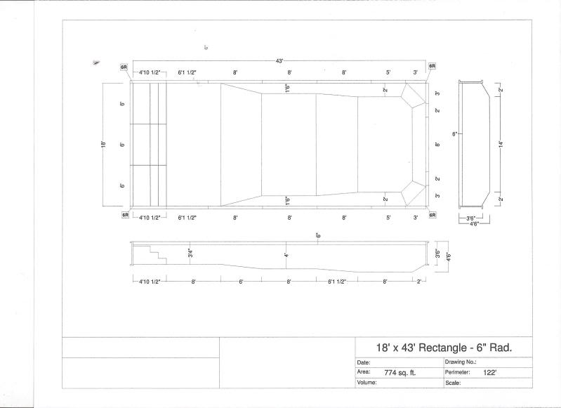

We're building an in-ground vinyl liner sports pool measuring 18x43'. Our PB uses Hayward equipment, we will have a heat pump and SWCG system. We also splurged on an auto cover from Coverstar, we'll see how we feel about that investment in a few years i guess....

Pool Design

Here is a rough drawing of the plan, we learned on the first day that we will need 2 steps between the patio and the pool decking.

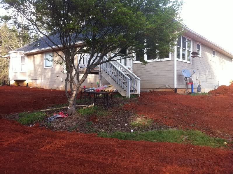

Thanks! I guess that's why we call it Georgia Red Clay. I'm about 40 mins. north of Atlanta. Pool excavator said we had good soil for around here, no rocks etc. He said it compresses great and we should have no problem with settling in the future.
We have a mountain of dirt at the moment...

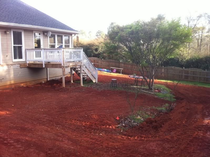

Grade is starting to look better

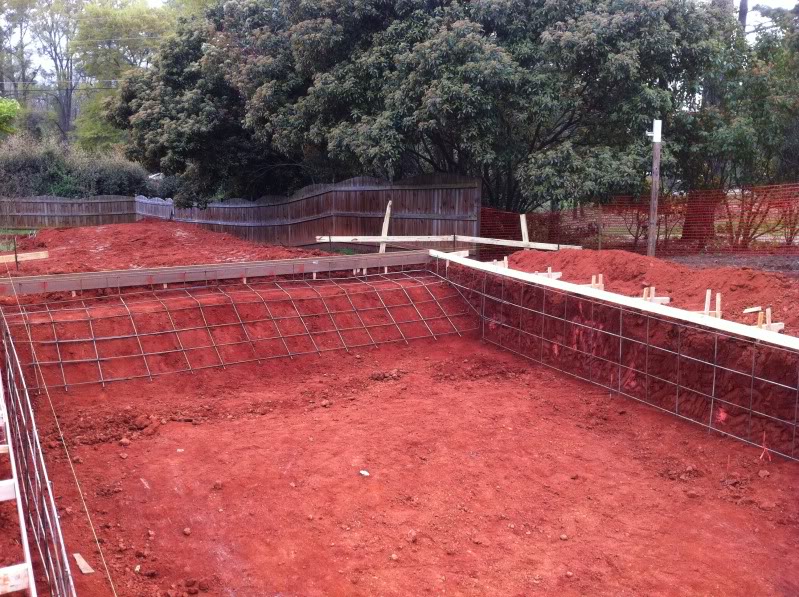

Oh and they are forming up the pool as i type, so i'll have pictures tomorrow, should have all the rebar in and the plumbing stubbed up, not sure what other "forming" takes place, but whatever is needed to shoot the walls full of shotcrete......

So is this a vinyl pool, or a shotcrete/gunite pool?
It's a vinyl liner pool, however they are making the sides like he would for a gunite. The reason being we wanted to shelves in the "deep" end, and we wanted full width 18' steps in the shallow end, and the first step will be 2.5' wide (like a small tanning ledge). In addition to that we are getting an auto cover. The PB said with those 3 things he would prefer to build the pool like a gunite vs. using steel sides. He doesn't like the steel forms for the supper long steps either for some reason. Ultimately it was our choice, he'd build it either way if we had a strong opinion one way or the other, we felt like he had some good reasons to go gunite style. Of course i dont' know if this cost him or saved him money, nor do i know if there is any reason not to have gone this way.
