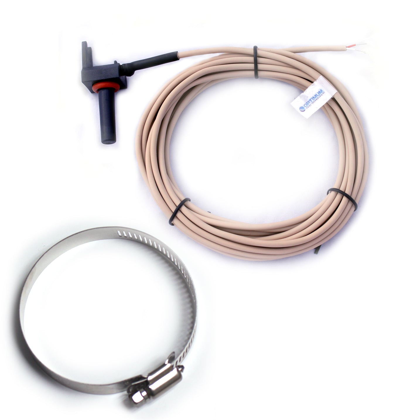

Install a temperature sensor in the pipe near the cell and wire it in.
