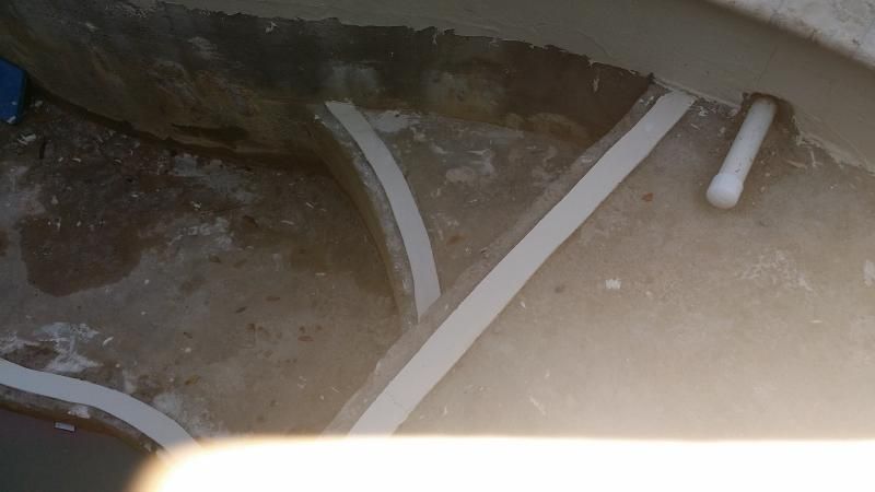

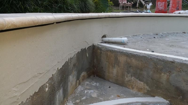

First step was to smooth out the surface where the glass would be installed. I used a 3/8 inch piece of weather stripping underneath the coping to leave room for an expansion joint. Then I troweled in a relatively smooth layer of the 254 thin set. I could not get it exactly smooth, so I'll go back in tonight and use a hand sander and/or grinder to get out the seams and rough spots.
I had to figure out a way to make a 3/8 inch padding of thin set so that the overall glass height (off the surface of the pool) will be consistent with the height of the plaster. I used 3/8 piece of weather stripping to make a form for this.
Then I just smoothed out a layer of 254 thin set in the space.
The result was a very clean foundation for the glass. This really worked out great and I highly recommend spending the $100 on the weather stripping to make the job easier.

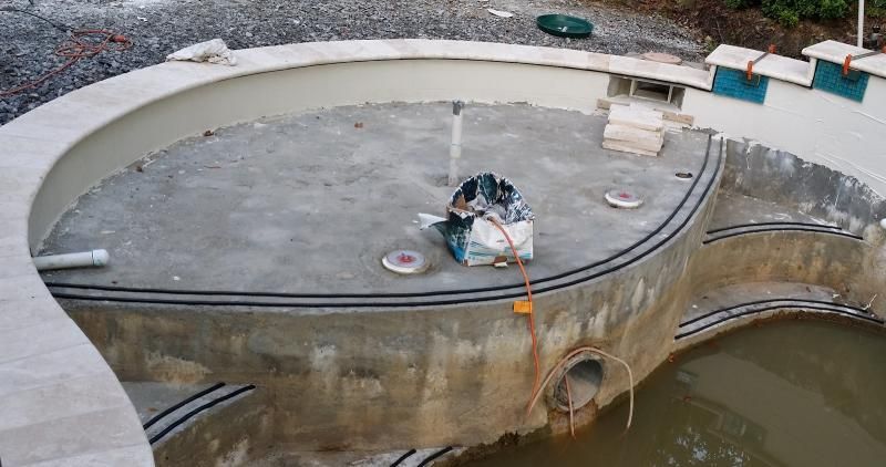

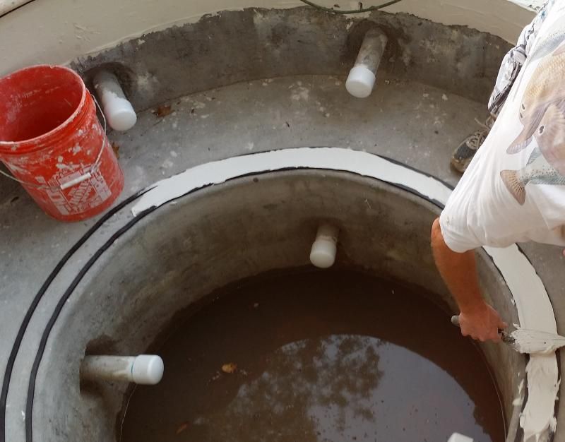

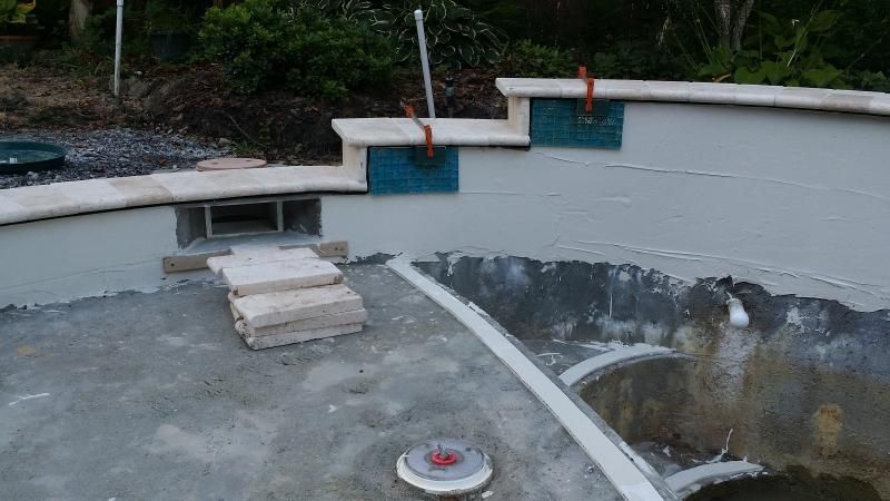

Spent two afternoons grinding smoothing out the base layer of thin set to get ready for the glass. then put on two coats of hydroban. This stuff was very easy to apply and only took a few hours to get it all in place. Notice how perfectly the color of the hydroban matches the pond scum that currently is ... my pool.
Then I got to work on installing the glass. It was not nearly as difficult as I expected. I figured it would take several weeks and it only took one. I figure this was mainly because I did all my leveling ahead of time with the coping. We are blown away by the tile (like everyone else who has used it on this site). It is really something to see. Amazing how it changes appearance depending on the lighting conditions. High noon direct sun is incredible. It takes on a multi-color'd gold/silver/etc color during that time.
It was well worth the waste in glass and multiple bags of grout to get a color that worked best for us. We ended up going with ployblend unsanded bay leaf color which is a grayish green. It blends in nicely with the arctic lagoon.
