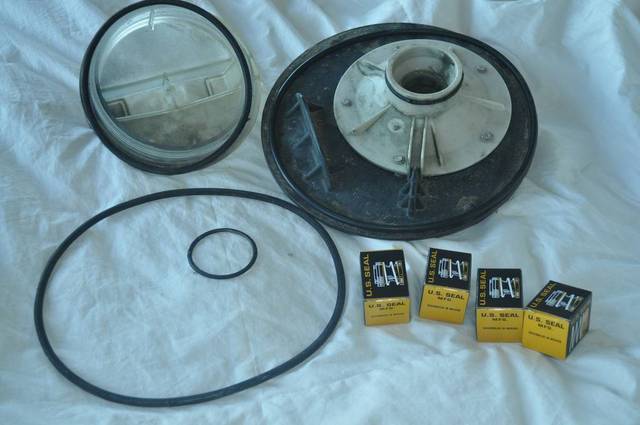

For example, my similar leak above was solved with a shaft seal.
I could have sourced the replacement using a standard 3/4" PS-201 Buna rubber shaft seal (Pentair P/N 37400-0027S) but the upsell was a Viton PS3868 (Pentair P/N 37400-0028S) shaft seal.
In keeping with the trade-size suggestion earlier in this thread, by sourcing trade sizes, instead of Pentair part numbers, I was able to fix my leak using the better Viton seal for about 1/2 the common price of the standard Buna (aka Nitrile) rubber seal.
You may also wish to note though, that the pool stores (e.g., Leslies) will put the shaft seal in properly for you for free - so, they do provide a valuable service if they're local to you.

BTW, the divergence of prices is even wider than shown above, if you include the resellers in the mix:
I ended up buying four seals at hottubwarehouse since the price was so good:
