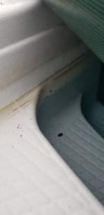

I couldn't wait, I kept thinking about it. The water level is about 1/2-1" below the first step. I honestly don't know where the weir door lines up with the steps, though. I never compared the two.
Now you can mark the current level on the steps and watch that level. With warm days and cool nights there will be a lot of evaporation.

The oring on the gizmo looks like it’s squeezed out a bit. Might check that. The seals on those are kind of a joke because they pop out like that. I have to screw them in until they just start compressing and then stop. You could also wrap the gizmo threads with Teflon tape.
