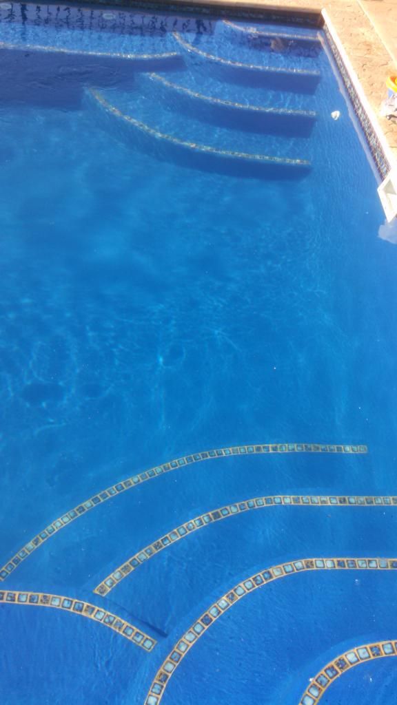

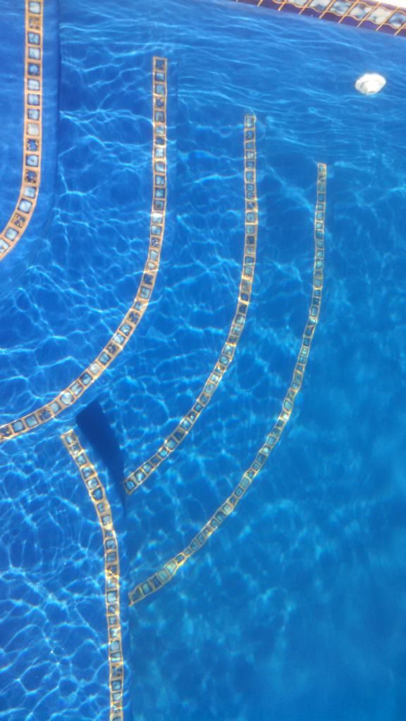

The insanity continues....consumed nearly 20 PPM of FC Today and pool is sparkly. I think it is time to drain the water and start over....any other suggestions ?
Here is one from the deep end
And yet another
