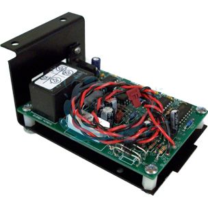

I found that 24vdc part - same number, just in 24vdc instead of 120vac.
Does anyone have knowledge of a reliable dimming relay I can use? When our pool was installed, we had a dimming relay for the spa light, but it have a life of about 3 to 5 years. After replacing it the 3rd time, we decided to just use a standard relay instead.
Has the reliability of the dimming relays improved? Is there a specific manufacturer that anyone would recommend?
