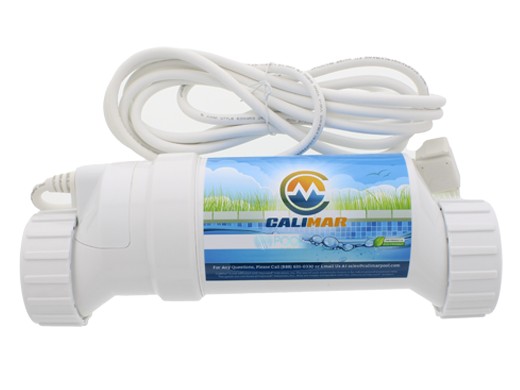

I assume the cell has died but I put it in a bucket of pool water and it bubbles, smokes and smells strongly of chlorine.
If the salt cell is working and the CYA is OK. what are some other reasons that my Chlorine might be 0?

What swcg do you have?
If that is the SWCG you have, you need to be running your pump 24 hours per day with the SWCG set at 80% give or take.

Is there a problem with that salt cell that I need to run it 24/7 @ 80%?
Marty means your SWCG is too small for your pool. It’s a common mistake builder make by thinking the rating on the device matches the gallons of water in the pool. It should really be rated for twice the pool size.

The “problem” with your cell is that it is undersized for your pool volume so you must run it longer to produce the necessary amount of chlorine your pool needs each day. (The gallon ratings of cells are based on running them 24/7 @100%) This is why we recommend one rated for at least 2x’s your pool’s volume.
When it is time to replace your cell you should get one rated for 40k gallons. (T15 or equivalent) this will enable you to run it much less.

One correction. I went to get the model number of my SWG and it looks like I misspoke. This is the one I have which says it is for 40,000 gallons.
So what I would like to know is how much should I be running this given my setup?

That’s great news about your cell!
Should be about 1.47 #/day output.
So about 10 hrs run time @100% in the peak of summer once your algae problem is resolved.
