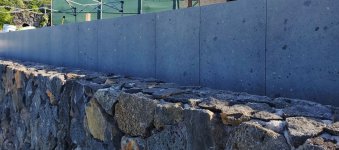

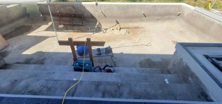

I'm building a pool as part of a new home construction project. Well, I'm not personally doing the building, but it's getting built! The project has been going on for quite a while and I should have gotten feedback from you guys from the start, but better late than never. I'd love to hear if you see any ways to improve the pool that I might still be able to act upon.
I'd like to find main drain covers, return jets, etc that look nice. I've seen some real eyesores. Any suggestions?
Sorry if there's many pics, I thought you guys might get a kick out of seeing a sort of time lapse from the very beginning. They are now preparing the drains, coping, and waterline tiles.

A couple thoughts and some more info:
  • The pool is 32'7"x11'10" (9.9x3.6m), excluding the steps. It's 5' (1.5m) deep in the center, 4' (1.2m) on the side.
  • I did make it bigger than original planned, but I think I should have made it longer, like maybe 42'. The pool was one of the first things that had to be built, so it had the least time to agonize over and get it perfect. Don't make the same mistake, go big!
  • It has a SWG, propane heater, and solar water heater.
  • There's 4 pumps: pool filtration, spa filtration, infinity edge (to run 24/7), and spa "hydrotherapy" (plus a spa bubbler).
  • There's no skimmers, the infinity edge is the skimmer.

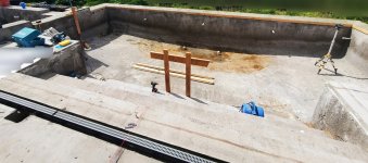

  • Apparently all the pipes in the walls are return jets except one larger one that is for suction (cleaning). The two pool main drains, spa drain, and outlet(s?) in the lower basin take water to be filtered. Does all that sound right? Is it common and good design for drains to be used as outlets like that? Dirt that sinks will be at the bottom, so maybe it'll work well.
  • If that's right, the pool (excluding the spa) has 9 return jets. That seems like a lot, no? What are the ramifications of having so many?
  • They didn't plan to use the waterline tile anywhere else. Do you think I should use it to trim the stairs and maybe spa seats? Maybe it's less busy without that.

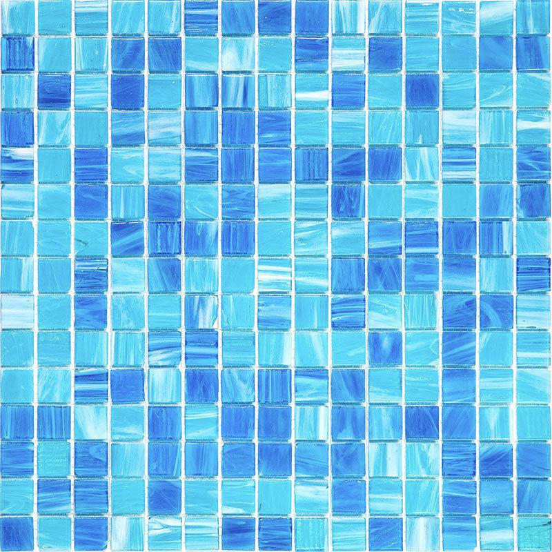

These are the waterline tiles:
Picking tiles was an ordeal. The pics don't do them justice, in fact I had to order many samples of all kinds of tiles, because the pics can't be trusted at all. They look better in person than they do on the site!
The plaster will be Hydrazzo Gulfstream Blue. I hope it's not too white and not too blue. I went back and forth between that and Catalina Blue, which I think would have been too blue.
Thanks for the channel drain link! Looks cool. I doubt it could be hidden any better than that. I wonder if it requires any special preparation in the gunite. I'll look into it more deeply!
I LOVE that tile! One thing to think about is what color of mortar to use under it. Get some paint cards to put under them. White, off white, light gray, med. gray. See which one gives you the look you like. You can also pick out different grout colors. White will make each tile pop where a light gray will help them blend together a bit. BOTH are very pretty!
Those channel drains are really no different to prep for that the traditional round ones. Instead of two round spots there will be one longer oval one with the pipe coming up at about the same spots.
The GC is on the channel drains! If it can be done, they'll make it happen. They have been amazing, making all kinds of crazy stuff I've come up with a reality. Stupidly expensive though (cost plus). YOLO ;)
Putting the sample tiles on different shades to pick grout is a good idea! The plan so far is Bostik Dimension grout in the color Diamond, which was recommended by the tile website. Do you have any experience with that? It's a little bit sparkly. It's not the whitest (Snowflake is whiter) but it's pretty bright. My thinking was I don't want the semi-transparent tiles to look muted, but I'm a little scared that Snowflake would be too white. Attached are two pics I found online of Diamond.
