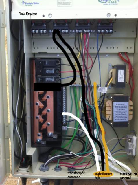

The IntelliTouch came with and without an internal salt cell power center. I doubt you have the internal power center, so I suspect that you will need it.
If you look inside your cabinet, if you have a salt cell power supply you will have two transformers. A small system transformer and a large cell transformer.
You need to check it out before moving forward.
Here is an EasyTouch pic for reference... (Disregard the colored lines, the pic was originally for something else..)
