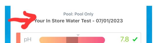

+1. Here's one from just yesterday that the poolstore had 71 and OP couldn't register any when the Talor kit came.
Stop trying to justify your #s based upon theirs. Whether they are right or wrong doesn't matter in the slightest, all that matters is what the Taylor tests say.
Even that's not 100% but it's WAY close enough for what we are doing.
Lol I’m not trying to justify anything; it’s my observation that my Leslie’s tests closely match my TF-100. They have for years now. That’s a good thing, imo.

Also, I know there are few fans of Leslie’s here, but here’s their numbers.
