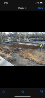

Okay so here is your first job in building your pool! Run out there with a tape measure. Is the pool deep, wide, long, etc enough?? Add about 6" for the steel, shell, and plaster.
The depth would be from the bottom of the pool to the middle of the skimmer opening. For the sides add 12" (6" for each side).
