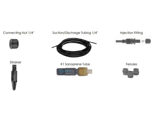

I found someone selling used Stenner pumps locally. If he has the correct model, I'll probably purchase it. I'll need to buy the injector, hoses, and tank. I plan to inject chlorine. Will this kit work for the pump?
