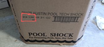

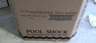

What do you mean by Julian dates? Are you referring to the picture I attached?
On chlorine bottles you should see a number. It may look something like 23-156 which means this is the 156th day of 2023. You'd be surprised how many stores sell old chlorine with 2022 dates still on them. Even some from early 2023 "030" day (30 Jan).
Yes, so still should be fresh as long as it wasn't stored outside in the heat somewhere.
