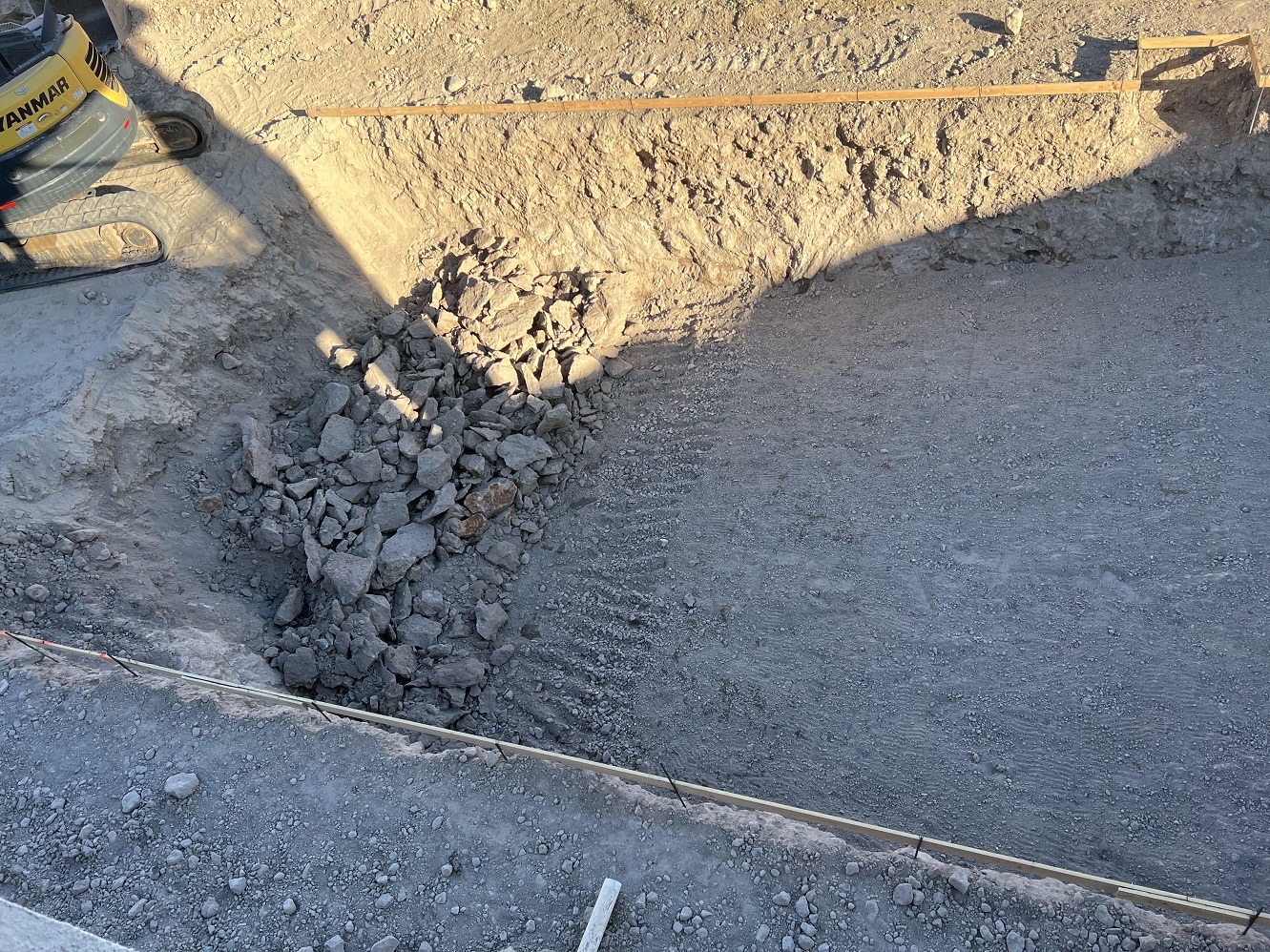

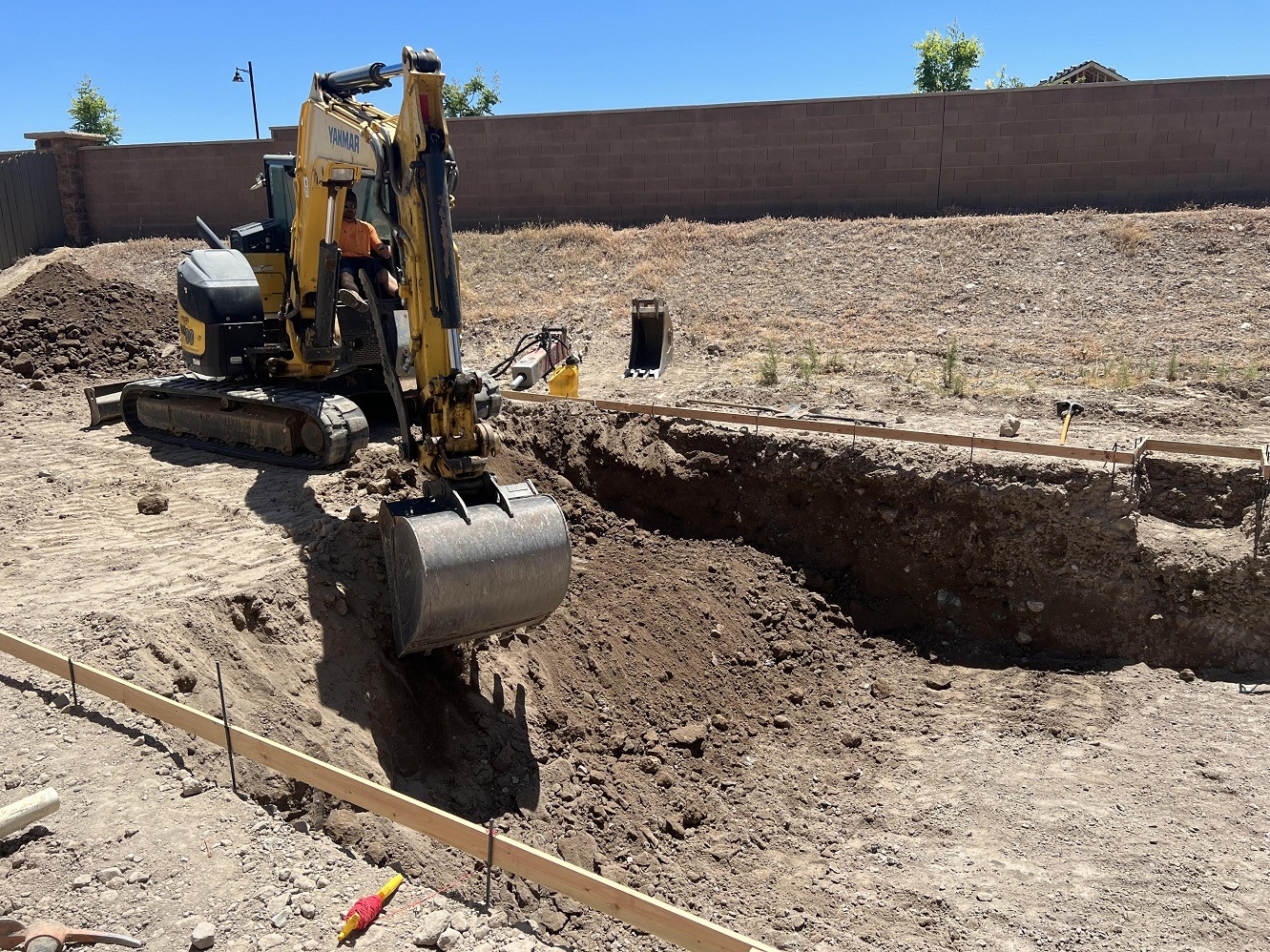

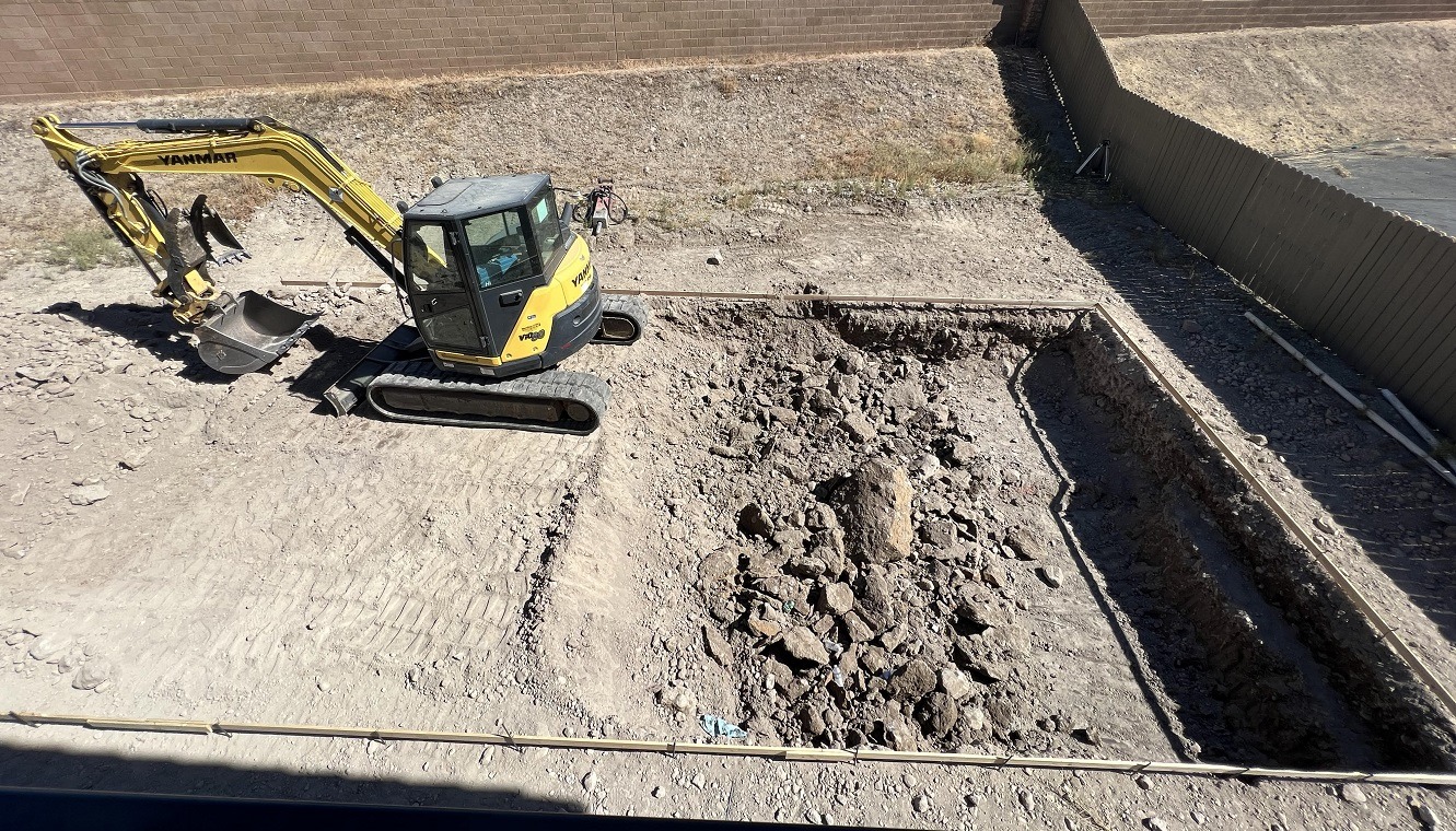

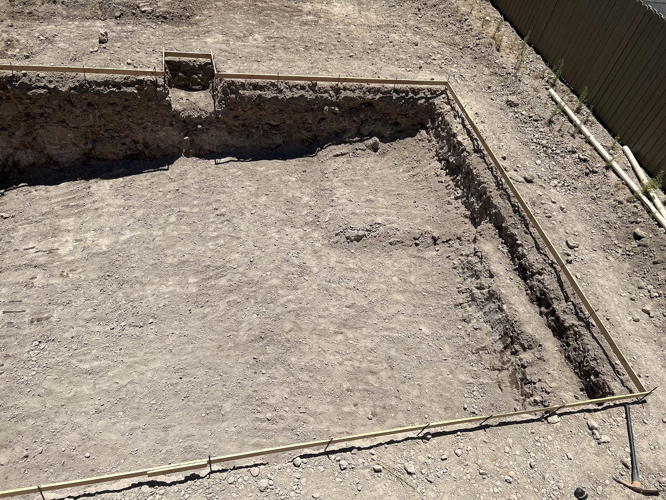

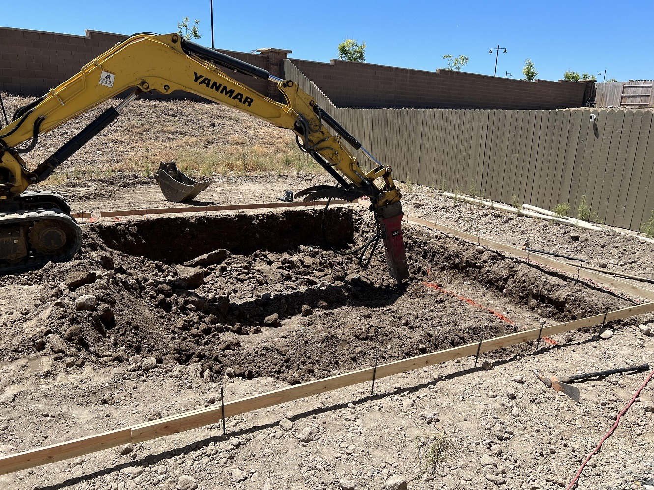

We've got a big hole in our backyard now, which included days of jackhammering through the solid rock in 100F weather. Plumbing and electrical next week :)

How much longer do they think they will be working on the dig? Make sure to take the plans out there with a tape measure to make sure it is long, deep, wide, etc enough. Add about 6" for the rebar, shell, and plaster. Make sure the depth talks about WATER depth. WATER depth is from the middle of the skimmer opening to the bottom of the pool. Some people do depth as from the coping to the bottom. When that is done you lose several inches of WATER depth.

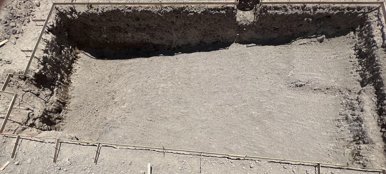

@kimkats dig is basically done. done a bunch of measurements, and watched them do measurements off the plans too. I've made sure to be very explicit about water depth vs depth from coping (multiple times). I'm not sure how to properly measure depth because I'm not sure where the vertical center of the skimmers will end up . They've been measuring from the top of the wood and have been told they go ~9" deeper which would imply the waterline would be about 3" below the coping? Top of the wood I believe is flush with ground level pre-dig.

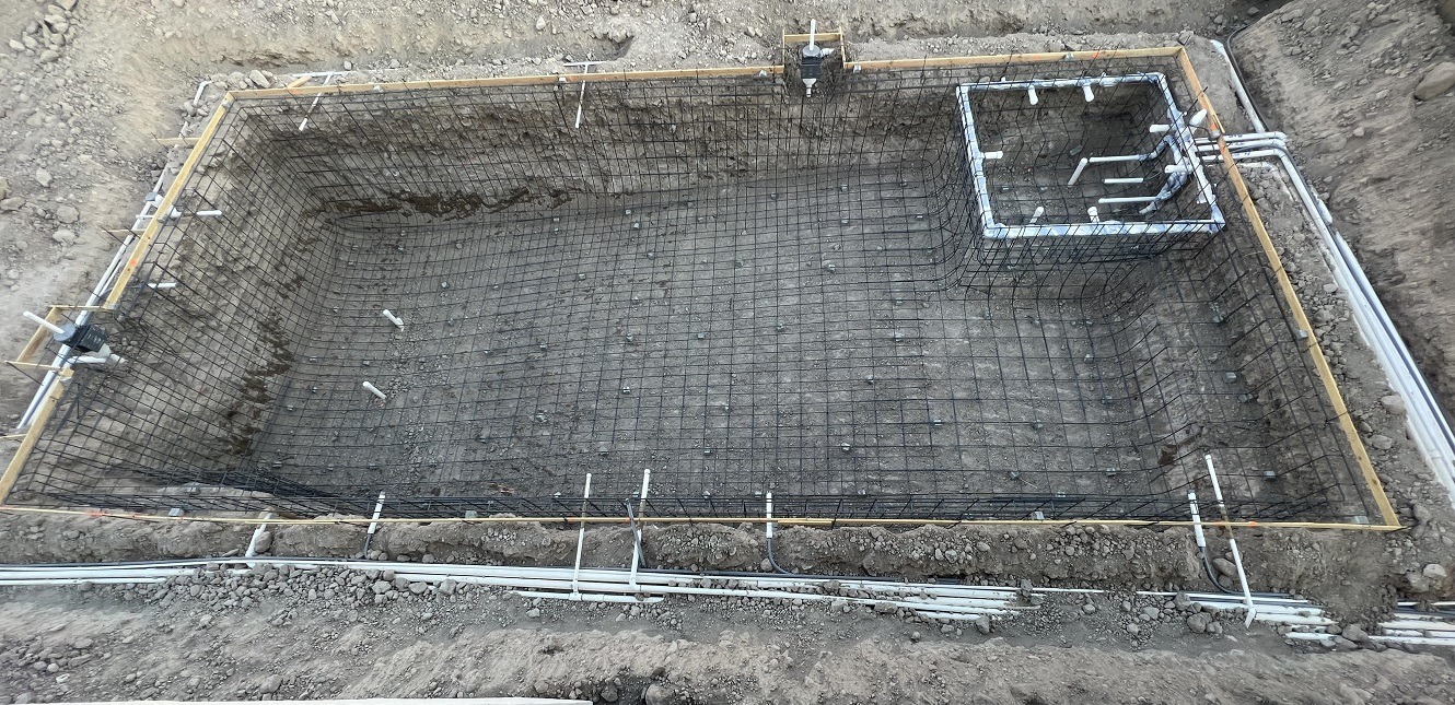

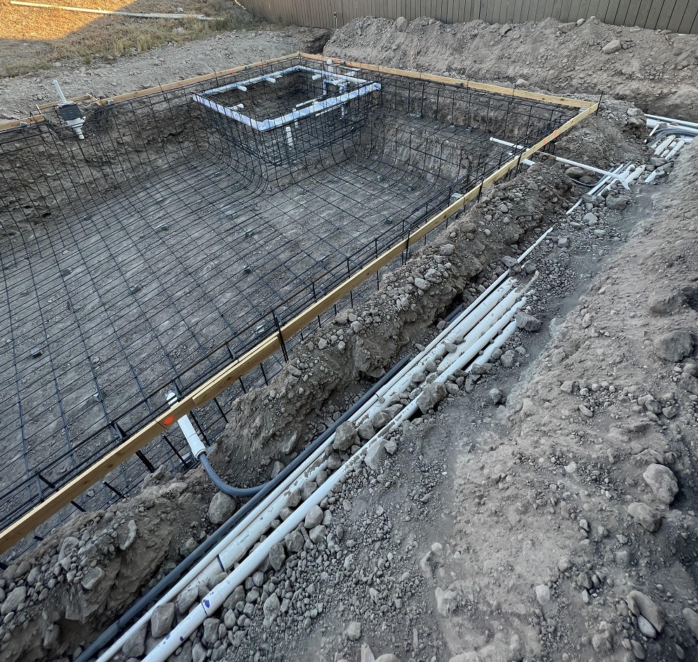

Rebar completed (soooo much underground piping!):

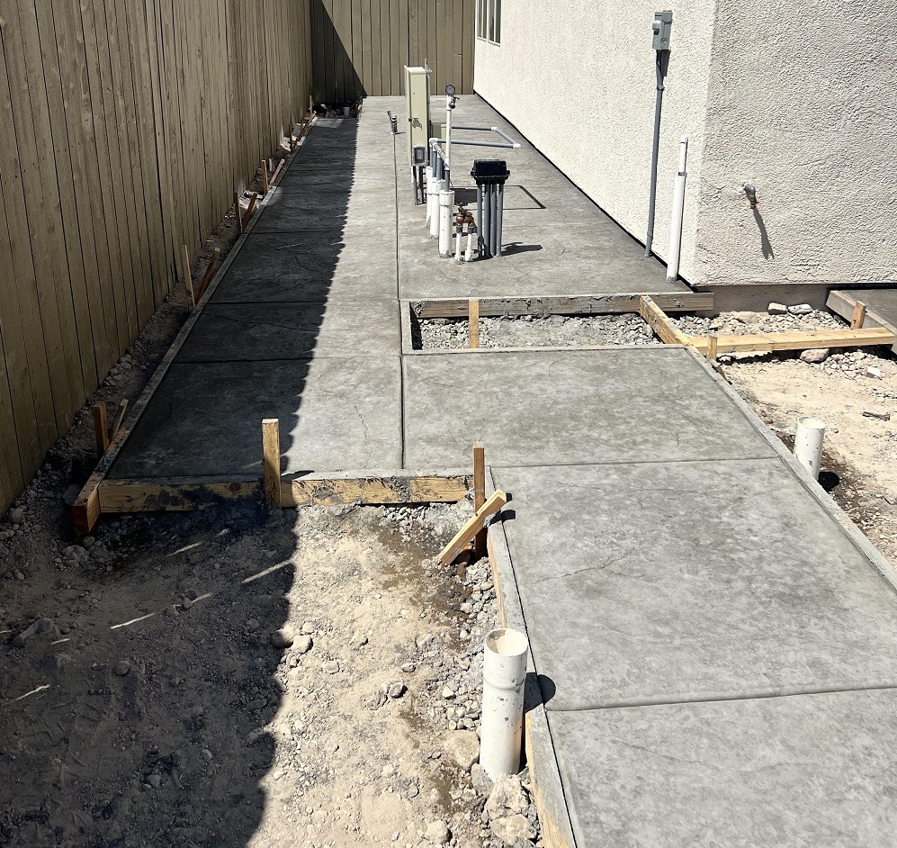

Concrete decking got poured:
Got a nice oversized pool pad:
Things I learned: Last minute additional gas lines cost waaay more than if you plan them in advance.
