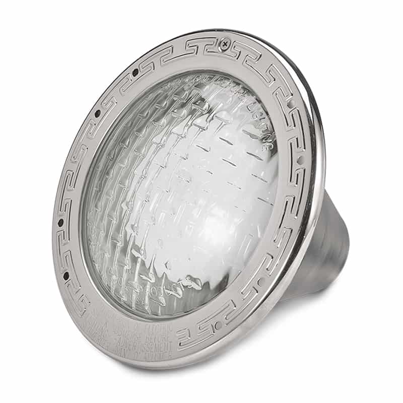

Also, the light on the deep end is out and needs to be replaced as well. What's a good light?

What model and size is your pool light?
Pump is on a timer switch by the pool, but all I can do with it is turn it off or on.
It looks kind of like this one. I will get an equipment overview pic after work.
Make sure you remove the light and scrub behind it.

The pool light is Sta-Rite and about 12" in OD

Sta-Rite Sunlight pool light.

Yes thats it and thanks for the advice. The impeller shaft is shearing so good possibility something is torqued out of place. Should I change the entire light unit. Here is the tag:
Model Sunglow
120v 500 watt max
Model Sunglow
120v 500 watt max
From the picture it looks like water has gotten into that light. The niche should be compatible with a Pentair Amerilite (the most common light in use) or any light that would fit an Amerilite niche.
