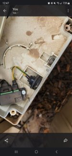

Jim,
I think this is it, it was mounted to the back of the ET. I could have probably gotten a better pic, further out. I will go through the screw and tighten them, maybe that's the reason it's works half the time.
It did always work until very recently, that's what puzzles me most.

Adam,
Your pump is connected to the bottom connector with just two wires.. At surge card JP3.
So basically, J20 on the main card is connected to JP2 on the Surge card, which then sends the speed commands out of JP3 back to the pump.
One thing you could do, as a test, is to unplug J20 on the main card and then remove the connector on JP3 and put it on the main card J20.. This would mean that the only thing connected to your RS-485 com port would be the main card and just the pump. If the problem continued, you'd know that it has to be a bad EasyTouch board or a bad pump, but it would eliminate everything else. If you did this, the SWCG and ScreenLogic will not work.. And this would need to be done with the power off.
Just something to think about if the intermittent problems continues as a way to troubleshoot the problem. Not something that has to be done now..
