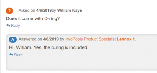

Finally, I looked at both kits and none of them say if the O-rings come w them, or inside the union threads. Does anyone know?
