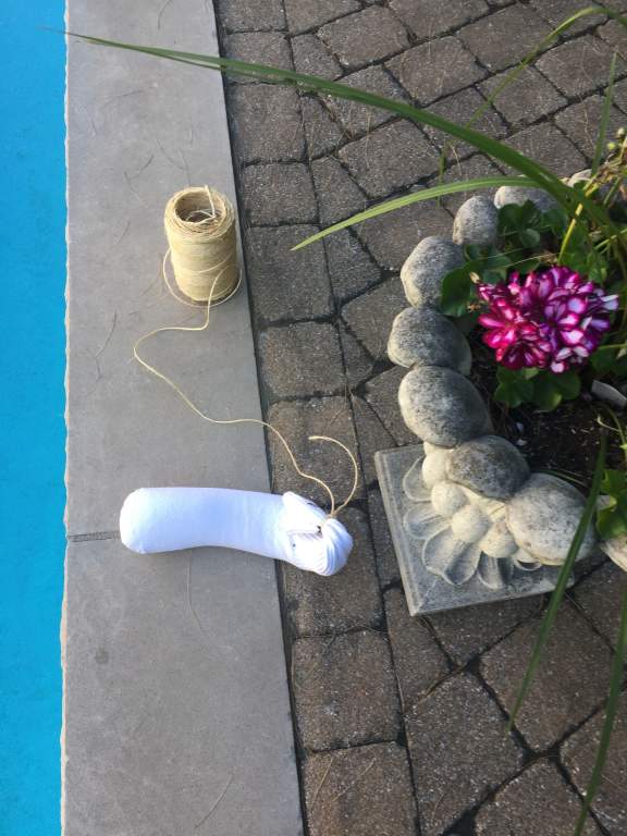

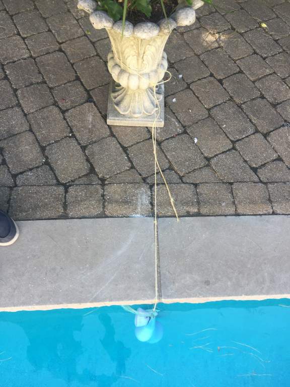

I can’t find the sock method for CYA anywhere. Can you link it for me if you know where it is? Thanks for the help!
Solid/granular CYA should be placed in a sock and the sock put in the skimmer basket or suspended in front of a pool return. If suspending near a return jet, ensure the sock cannot rest against the pool surface since the granules are acidic and could potentially discolor the surface. After adding CYA you should leave the pump running for 24 hours and not backwash/clean the filter for a week. After soaking for about 30 minutes, squeezing the sock periodically will help it to dissolve faster. Test and dose chemicals in your pool assuming the amount of CYA added is in the pool according to Poolmath. CYA can be tested the day after it is fully dissolved from the sock.
