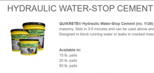

Here are the products recommended by my rock guy. The Minwax paste provides some protection, but requires frequent applications. It only takes a few minutes to apply and remove excess.
Use this to fill cracks...
Follow up with paste wax...
