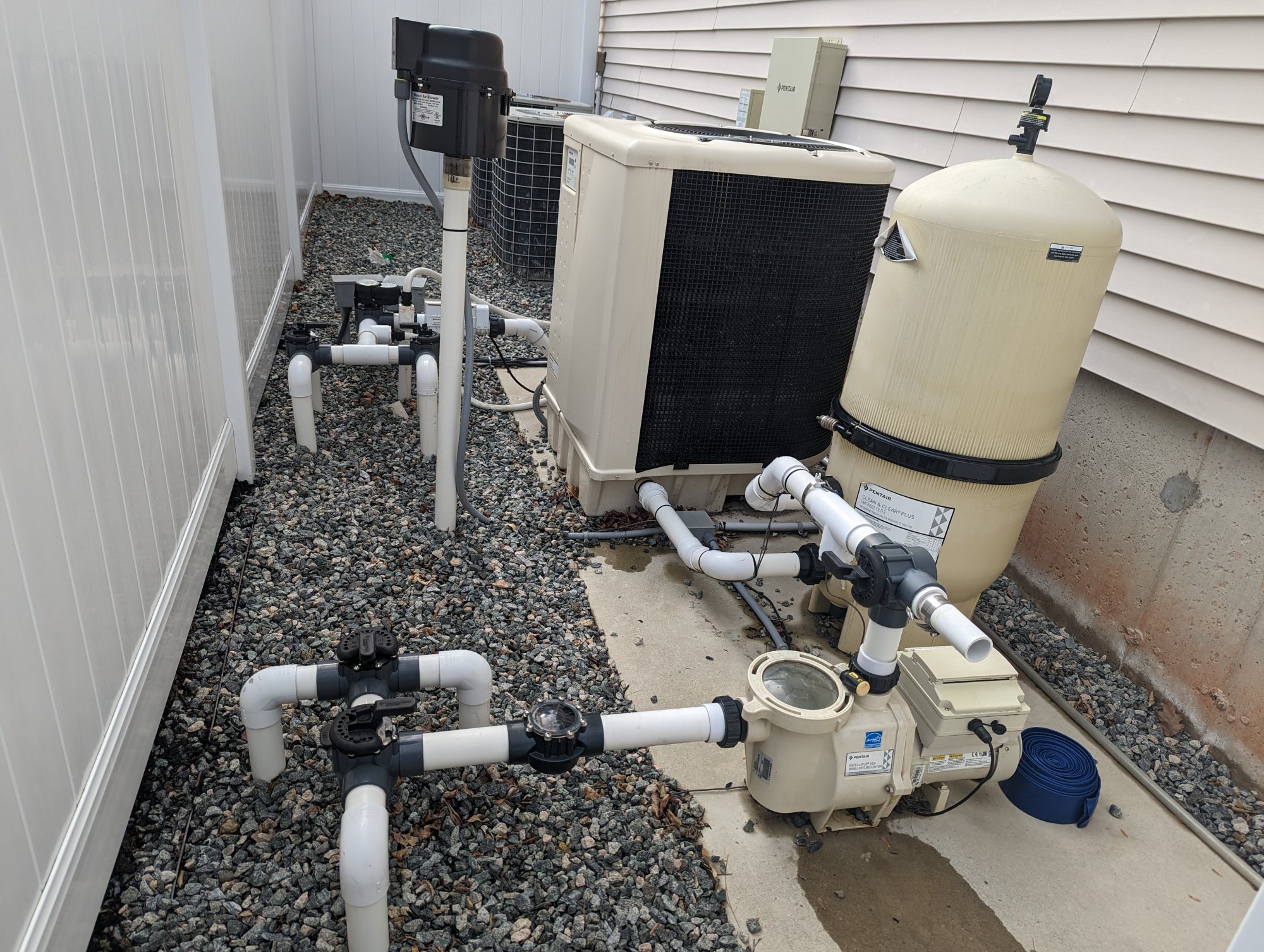

Mine was run to a dry well per local code. The code was enacted to protect the rear yard neighbors who frequently get flooded yards, but I have nobody behind me and codes don't care about reason. Lol.
The drywall can only handle so much water so I whacked the pipe so I can drain at the pad (my lawn likes the pool water) I'm probably going to use the drywall for an outdoor shower, now that I have it.
Anywho, here's another setup.
