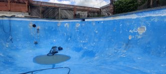

I've identified all the loose spots with the hammer tapping technique, with two of us working in a grid pattern to avoid missing any spots. Since my last post, all the rusted spots have been cleaned out, converted/neutralized with Corroseal, and packed with Drylok Hydraulic Cement. I have a little more work to do on cleaning old thinset from the top border and we are ready for fresh plaster repair.
Another very hot day, so taking a break just now while I wait out the sun. Today was mostly focused on creating a safe workspace... pictures to follow shortly :sleep:

Current (recent, including some photos as of today):IMG_20220710_141214.jpg
Got up early to fight the sun...
All delineated plaster and failed patches/repair spots have all been removed, and the stairs are ready for replaster and tile (backsplash/face only)
I'm exhausted! Heading back out for more clean-up.
Reactions: kimkats
