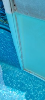

Please help me diagnose this! Pink bacteria

Hello all: I just want to take some time here to thank everyone for coaching me through this SLAM process and encouraging me to stick to this. Chlorine has been much easier to control now in my pool, there is no sign of the pink bacteria returning, and the water looks incredible. The staining is even starting to lift now using Metal Magic and Jack's Pink Stuff at very low doses. Thank you all again so much!
My only issue right now is high CYA around 70? I am going to consider draining the pool by about 50% here using a pump and refilling to lower the CYA.
