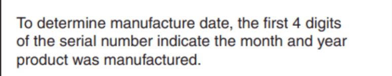

Can you show the dome threads and the filter threads?
Can you show the filter label with the date?
The dome thread is now brand new (152519Z), the original did the same thing. I saw something about the V type is an older version, mine is 2020ish sand filter

You probably have an obstruction in the returns or maybe a valve misconfiguration.
The tank looks about 23 years old, not 5 years old.
All lines have been blown with the output lines taken off. I don't see an inbound obstruction would cause but will look. Bought the tank in Phoenix 5 ish years ago still in the box, but who knows
It looks like you got a used filter with damaged threads whenever you got the filter.
I think that the filter is probably about 23 years old.
In any case, I would replace the filter.
