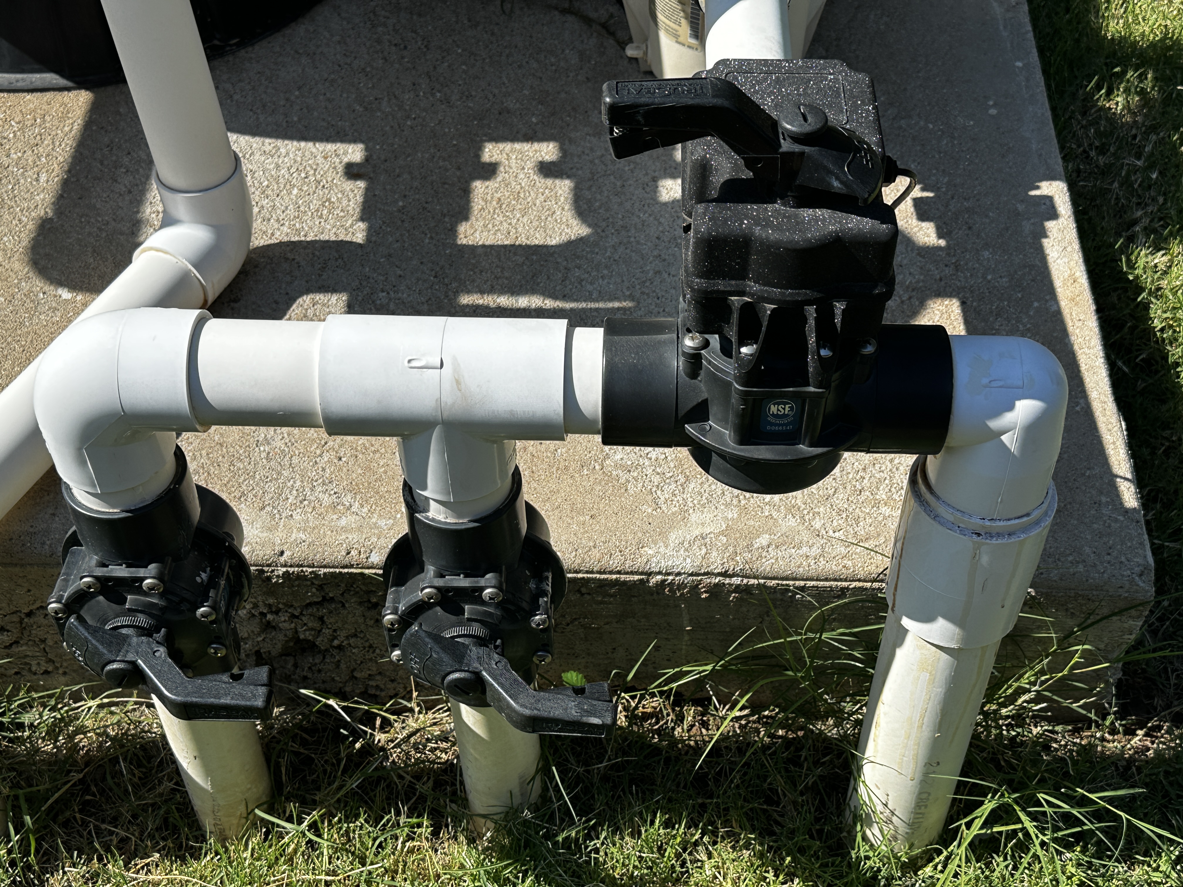

Ok, let's start with pictures.. You are seeing the pictures in POOL mode (returns are 80/20 Spa/Pool and intake is 100% pool). When in SPA mode, intake valve does a complete 180, closes off pool and return valve closes off the remaining 20% to go just to SPA jets. Right now, filter is running at 1600 RPM and pressure is 5 +/- Psi.. There are 3 spillovers coming out of a 8ft spa (6 jets). Spillovers ONLY run in pool mode. In SPA mode, water level drops in SPA below spillovers.

I looked at your plumbing pics and you have two inputs to your pump when in the Pool Mode. Most likely the two inputs are the Skimmer and the Main Drain.
I suggest that you only open the main drain line about 5 or 10%. Main drains are not really needed at all. This should increase the skimmer suction.
No way for me to know which pipe goes to the skimmer and which goes to the main drain. You will have to test and see. Go look at the skimmer and see if you can see or feel water being sucked from the skimmer and into the pump. (You should). Then shut off one of the two valves and go look at the skimmer again. If the suction action has stopped, you will know that the valve you turned controls the skimmer line. If the suction action did not stop, you will know that the valve is for the main drain. You never, ever want to shut off both valves at the same time!!!
Note that you may have two drain covers in the bottom of your pool, but only one pipe into your pump. This is because the two drains are tied together so that if you sat on one, it would not have enough suction to hold you down. A safety feature.
SO the SKimmer should have most of the suction with the drains only being about 5%, not the full on config it is now.. got it..
