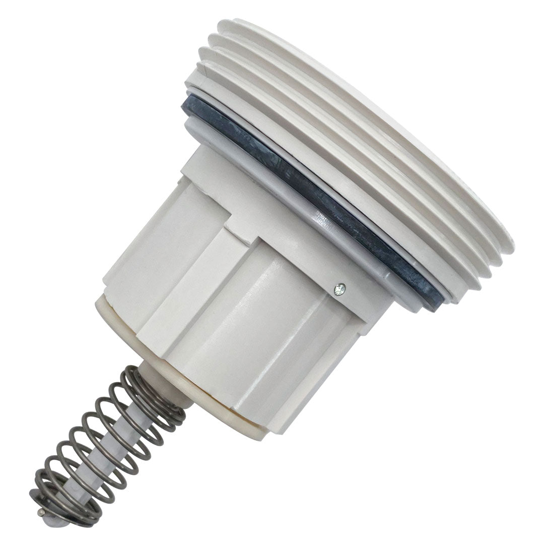

I finally got a stuck paramount valet popup out of its socket but destroyed the popup in the process. The socket threads are still fine.
Unfortunately the paramount valet popup is discontinued.
The recommendation seems to be the a&a (now pentair) retro with the spring, but I don’t have enough pressure to defeat the spring so they don’t fully popup.
I tried to cut part of the spring off to reduce tension but then it doesn’t lower well since there is no weight.
Any other options for replacements? I do like the design of the pentair but I guess would need something rated for a lower pressure system. Do they make lower tension springs or something?
