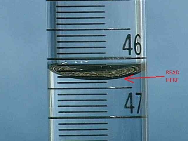

Are you swirling the solution after every drop of R-0871? Also, make sure you have enough water so that the bottom of the meniscus is at the 10mL mark.
Yes, I'm swirling, shaking it after every drop. I'll make sure I have the menisucs at the 10ml. mark next time.
