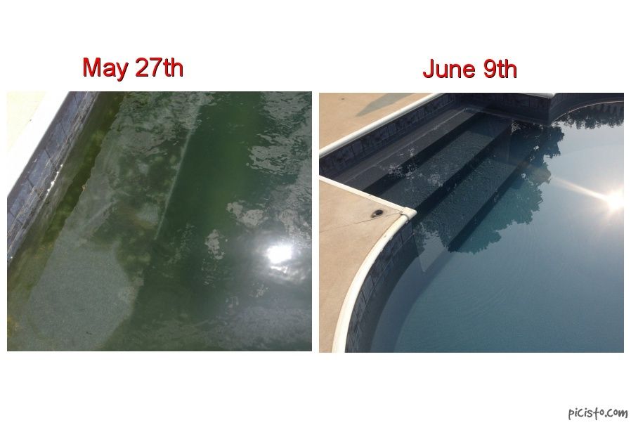

Just keep pounding it Teerump, that and what you are doing sweeping and vac'ing will get you there. Honestly, as Black as it looked at the start, this is going pretty well.

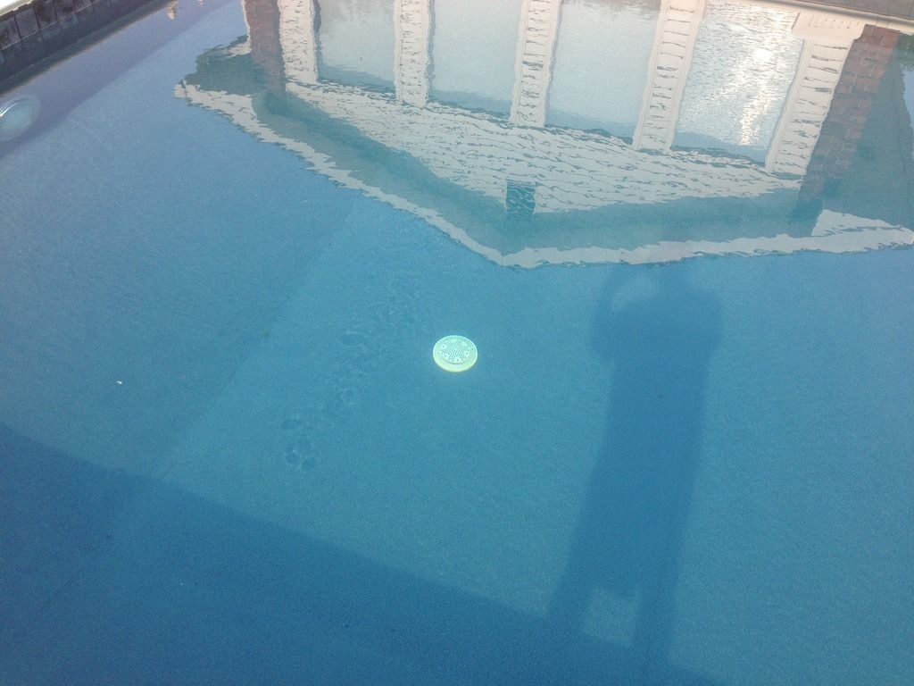

Looks good. I can't say for sure, but if I had to guess I would say by this weekend if not sooner. Have you tried a OLCT to see if you pass overnight loss?

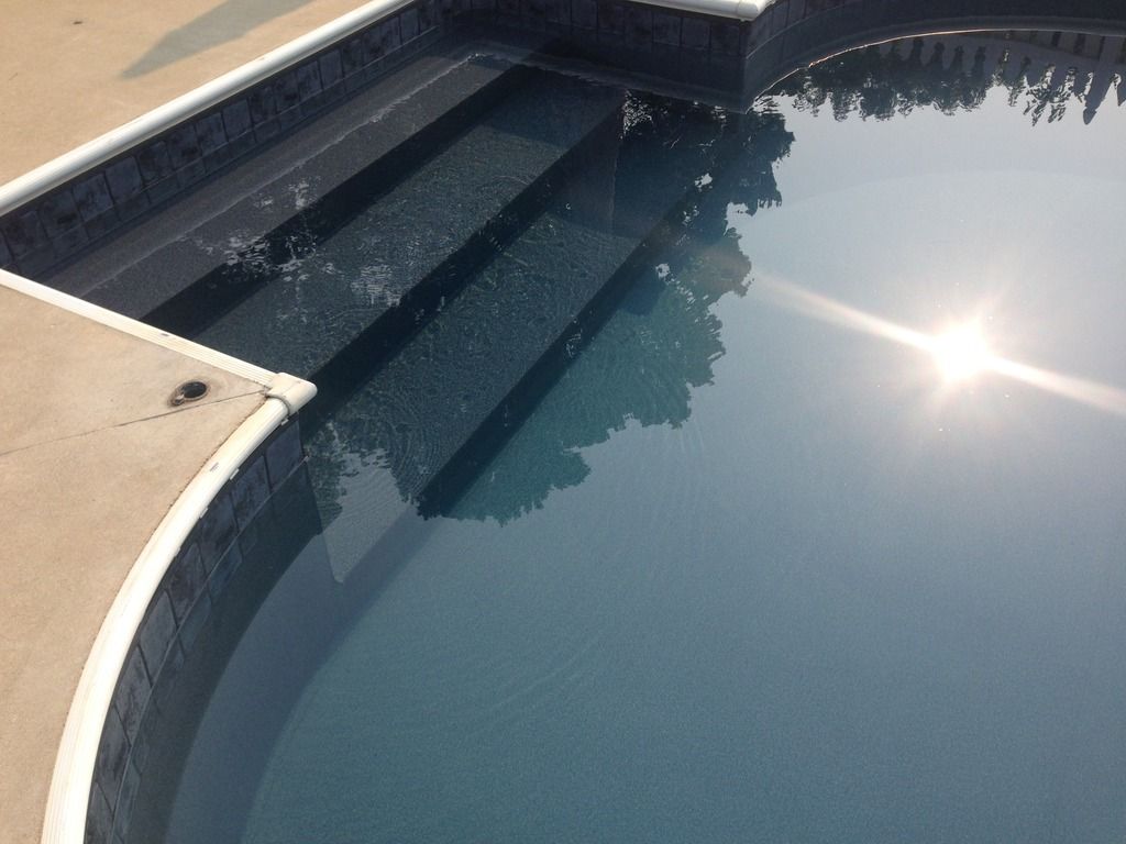

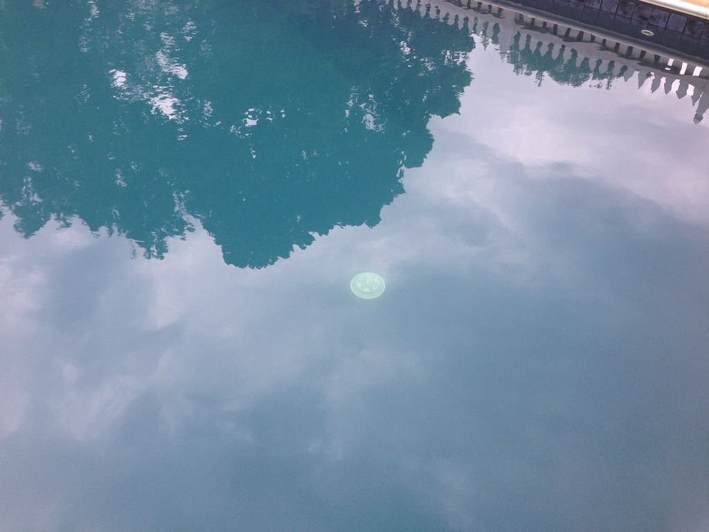

Today is the first day it's been this clear, to me it still looks a little cloudy in the deep end. I did ad DE to the filter. Within 30 mins. my pressure was up 7 psi. I backwashed and added some more.

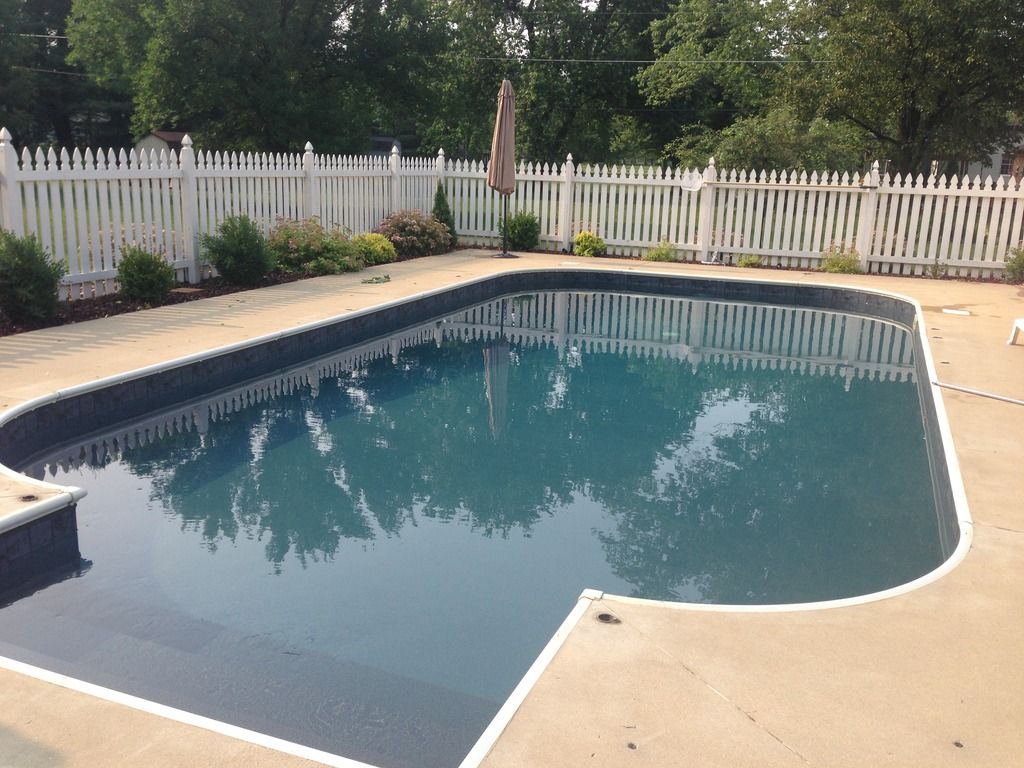

Didn't do the OLCT test yet. Planning on tonight. Water looks very clear, had alot of rain last night, I need to vacuum again, but otherwise the water looks great. Assuming I pass the OLCT test, then is it just a matter of letting the chlorine level drop on it's own? And safe to swim is once it's below Shock level for my CYA correct?
Once you pass all the criteria for the SLAM you can safely swim at any FC below SLAM level for your CYA. Don't run a full set of tests until FCis below 10. Then test PH and FC daily. CYA once a month and all other tests once a week.
