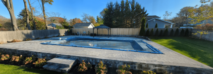

No matter what you choose there are some key things that need to be kept in mind.
Everything is going to take some type of maintenance. I try to avoid pressure washing because it forces water is places it normal would not go, blows out the polymeric sand and can deteriorate the surface of paver, concrete, and tile if not careful. I touch up polymeric sand in spots that is has come out of. I try to use chemicals to limit moss growth (shady and damp areas do promote moss growth, good drainage should eliminate this issue). If ants are seen, treat the area to limit what damage they can do. Putting off maintenance just makes more of it later on.
Proper install is critical. If it's done poorly you will have more maintenance. Making sure the underlying material is appropriate and compacted well. Drainage and water management is really importance. Read and follow the instruction for the materials being installed. If you having a contractor do the install, look over the materials and products they are using and ask questions. I had my contactor change the polymeric sand because the one that was delivered was not for pavers over a slab.
In my experience polymeric sand doesn't do well by just adding to existing, it would last and look horrible in just a few months. It diesnt really bond to the exsiting and then you have a thin layer of sand on top of another thin layer of sand. This is why I would pressure wash the whole patio every 2 years and resand...having it over a slab is a cool idea tho and could potentially help and alleviate a lot of the issues with pavers, mine is over a stone base so this is where I'm speaking from. I could say I would never use a paver decking over regular or traditional base around my pool...to much maintenance, to much mess, to much work, and somehow I see all that mess ending up in the pool.
We have a paver patio/basketball court and a hand carved joint & stamped surface concrete pool deck. I prefer concrete over our paver installation around the pool for it's cleanliness. Zero grit, no ants, no weeds. Yes to cracks, stain that faded, and being too hot to stand on in 95+ days (get feet wet, go fast, or wear flip flops). But after 10 years I re-stained (with acid stain this time) it and it looks like new. Cracks don't bother me as they are smooth and thin and not that large in number.
I don't mind the pavers for patio/court (overall look is more consistent over the years). After 10 years I powerwashed and re-sanded. In between I use Wet & Forget spray. Our base was stone dust (6-12" deep), which isn't particularly recommended at large, but our contractor swears by it locally and it has held very well with no shifting, which is the major downside associated with it. Stone dust can vary regionally regarding it's source stone and ultimate makeup.
I have no personal limestone or travertine experience.
