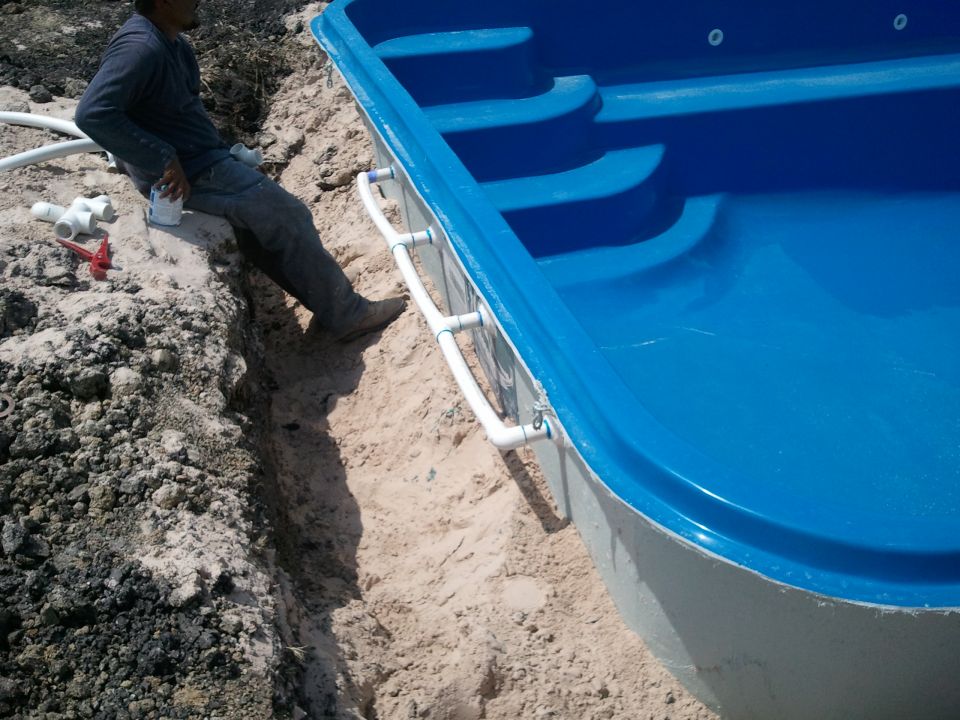

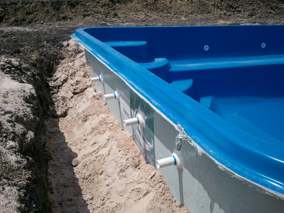

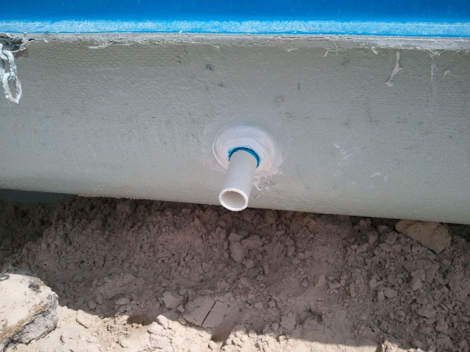

Okay, perhaps that's all they had on hand at the tme of install or something. Does seem a bit odd. But with a leak, you'll need to re-do the whoe jet connection anyway, so I suspedct you'll remove all of that anyway. Below is how mine was plumbed and installed. Maybe that will help give you some ideas.
