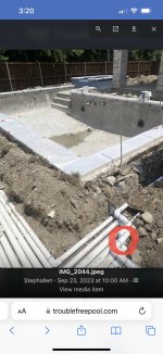

This is probably the best pic I have of the plumbing that runs under these concrete pads.

I'm suspicious of a pinhole leak or small crack the undergound plumbing. You have some fairly large boulders in direct contact with your pvc in this photo.
A good PB will backfill this with imported sand. It reduces voids, plus nicks and localized stresses when the ground shifts and settles.

Ya they did backfill with sand, but you are correct this area does have a lot of large rocks sitting on top of that plumbing.
I’ll send this pic over to the PB to see if they might agree and just break up this concrete area to see if they can find the leak.

There was already a coupler placed here right before an elbow so they may of had some issues. Of course the pipe just may of been just short of where it needed to end up.
