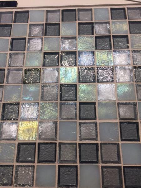

Thanks Tony! Everyone who has seen the samples has voted for the blue (Aqua). It was my first choice too, but I'm also waiting to see it in all aqua iridescent, as well as a few other colors. Those samples should be here tomorrow. ?

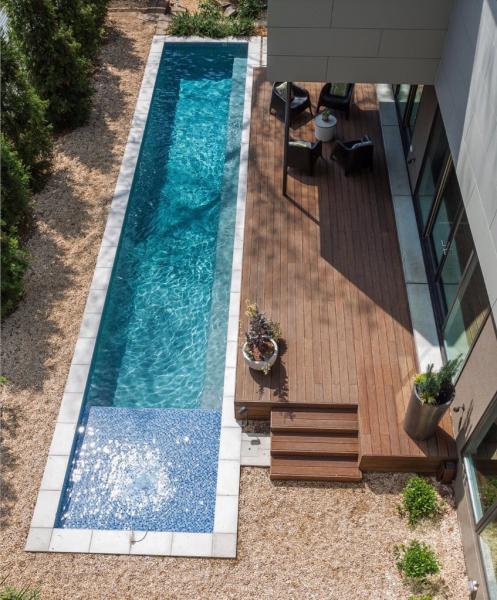

I would LOVE to tile the bench and steps at the end of the pool, but our PB thinks that's a bad idea for safety - and also keeping a long term watertight seal. I'm so sad, because I love how it would look. I've kept these images of a pool for a couple of years now with a tiled shelf.
He makes a good point about grout eventually failing to be waterproof, but I LOVE the way the tile looks here:

I am interested in using aquaBRIGHT if I refinish my pool and one of the benefits is that it is much more maintenance free and chemically inert as well as forming a continuous watertight surface. You will lose a lot of those benefits if you tile part of the surface.

1) Regarding tiling the benches and steps. Prior to installing the tile, a waterproof membrane is applied, which should minimize the chances of a leak. There are 1000's of pool that are completely tiled, so it must not be a concern if installed properly. If you are using a 1 inch or smaller mosaic tile with many grout lines, that will provide friction and reduce the chances of slipping. There are also Matte tiles for this purpose. They are the same color as regular tiles and can be interspersed to provide friction.

By the way, did you get the iridescent tile samples today? Would love to see those.
