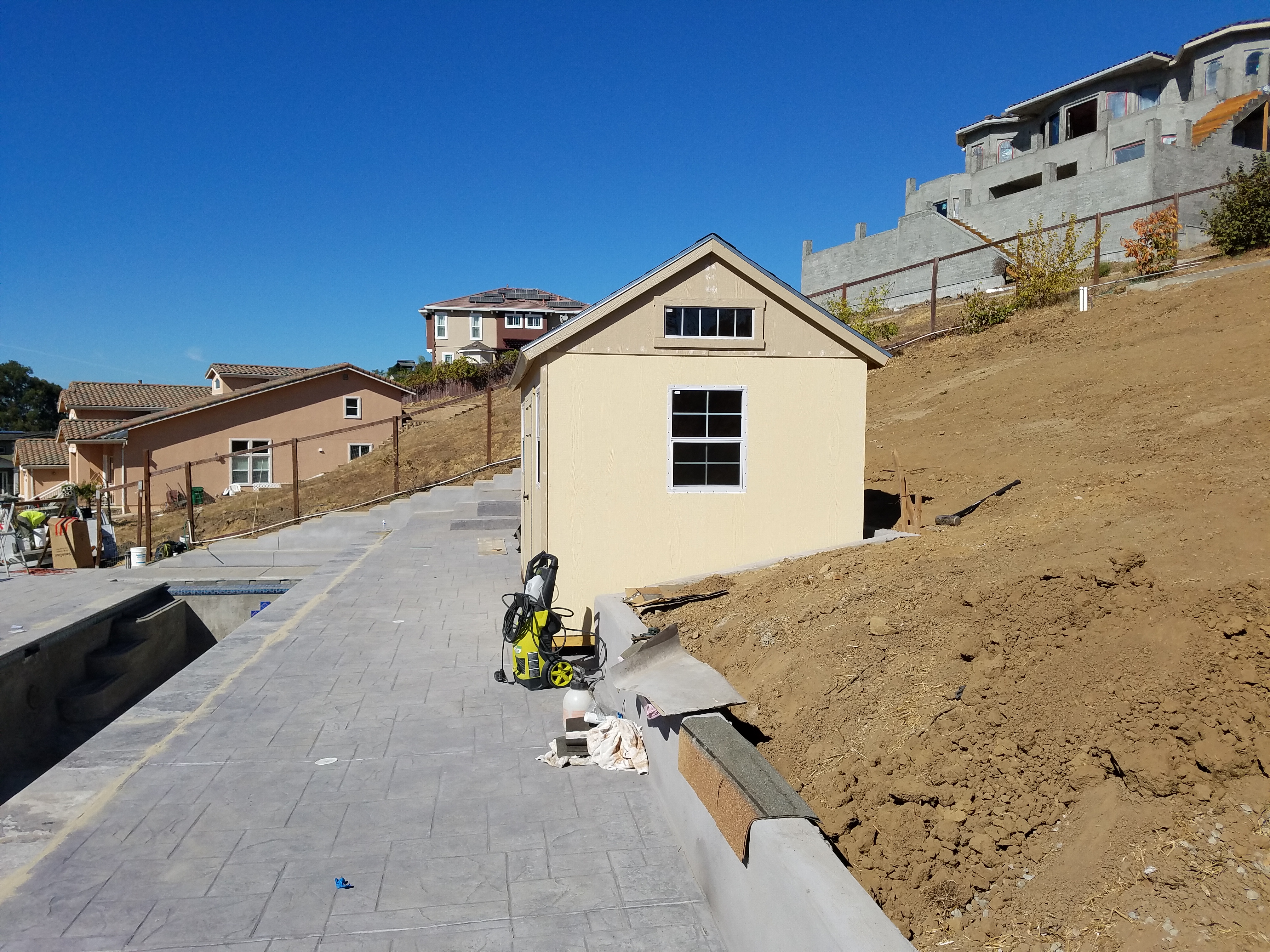

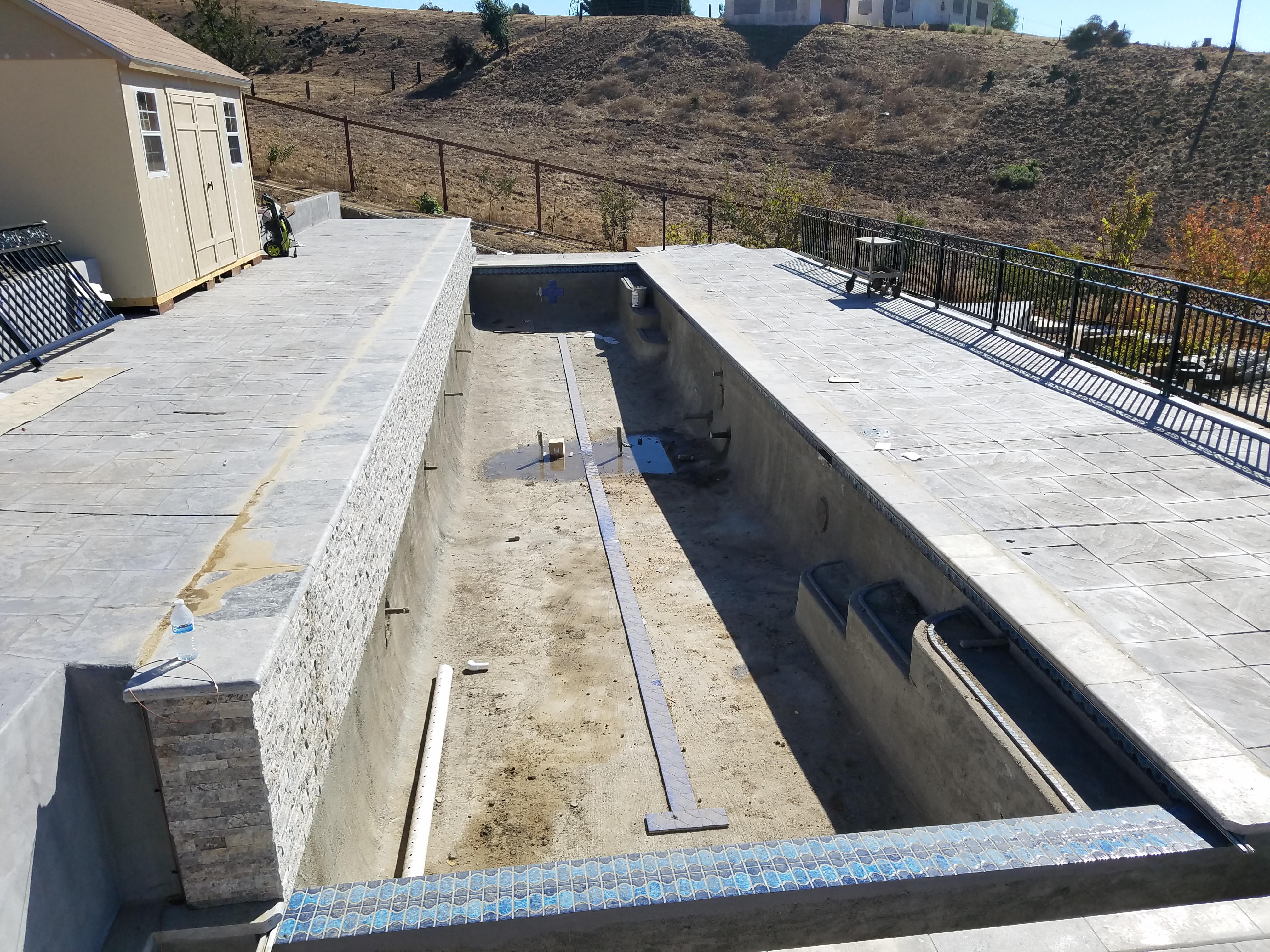

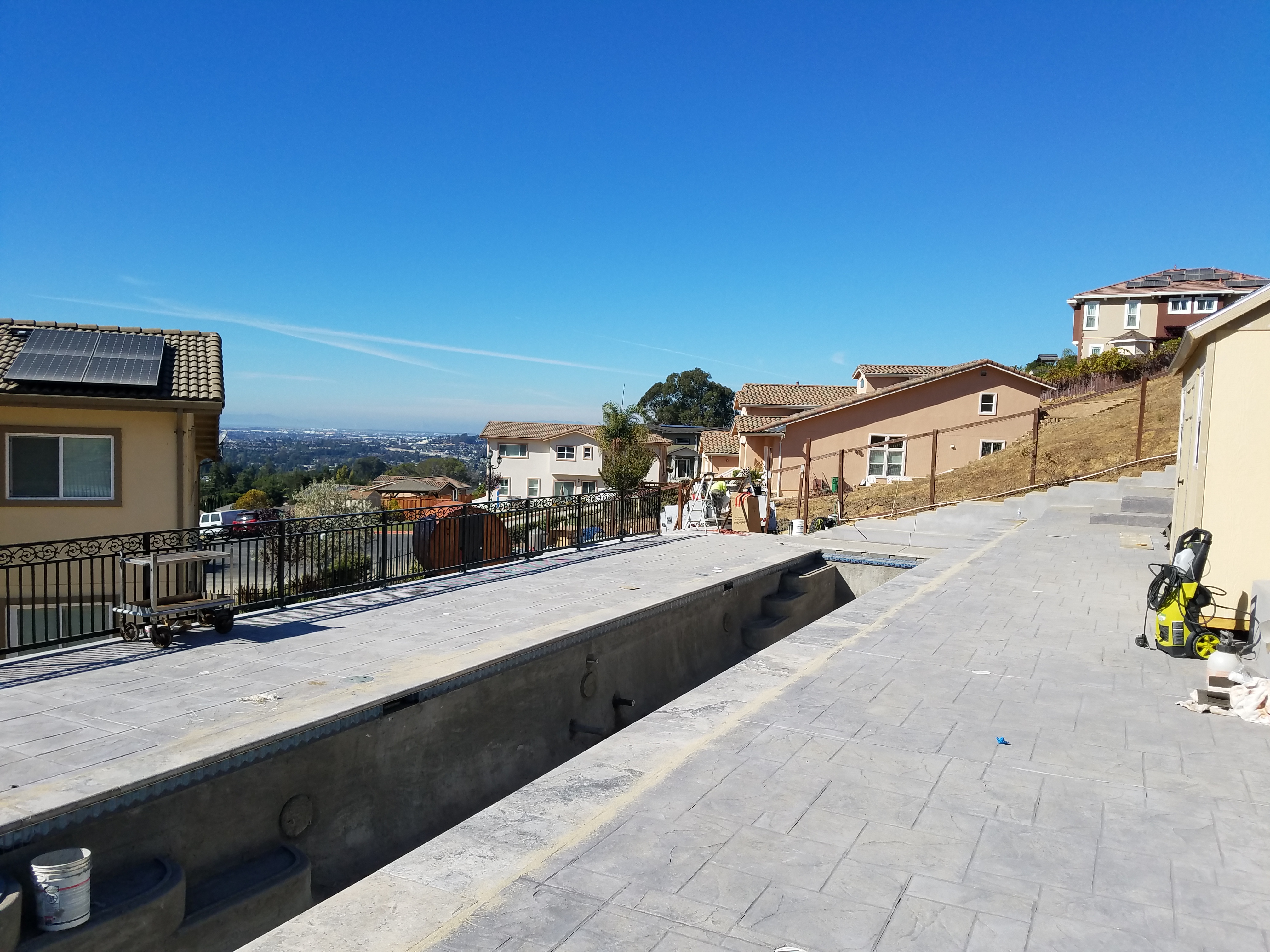

It's been a while. But we're getting close. They're installing the equipment now. They say we might be swimming in a couple weeks. It's been a long haul. The pool guys finished the gunite shell in June. Then they went away. Our concrete guy flaked. We found another - really good - concrete guy. But like all really good contractors, he was booked way out. He started on August 6th. He said it would be about 3 weeks. He's almost finished now :). It didn't help that he had to build an enormous retaining wall. The footing for this thing is over four feet wide by 20 inches deep, with a 1-foot-by-1-foot rib in the middle. The cost for all this is getting pretty mind-boggling.

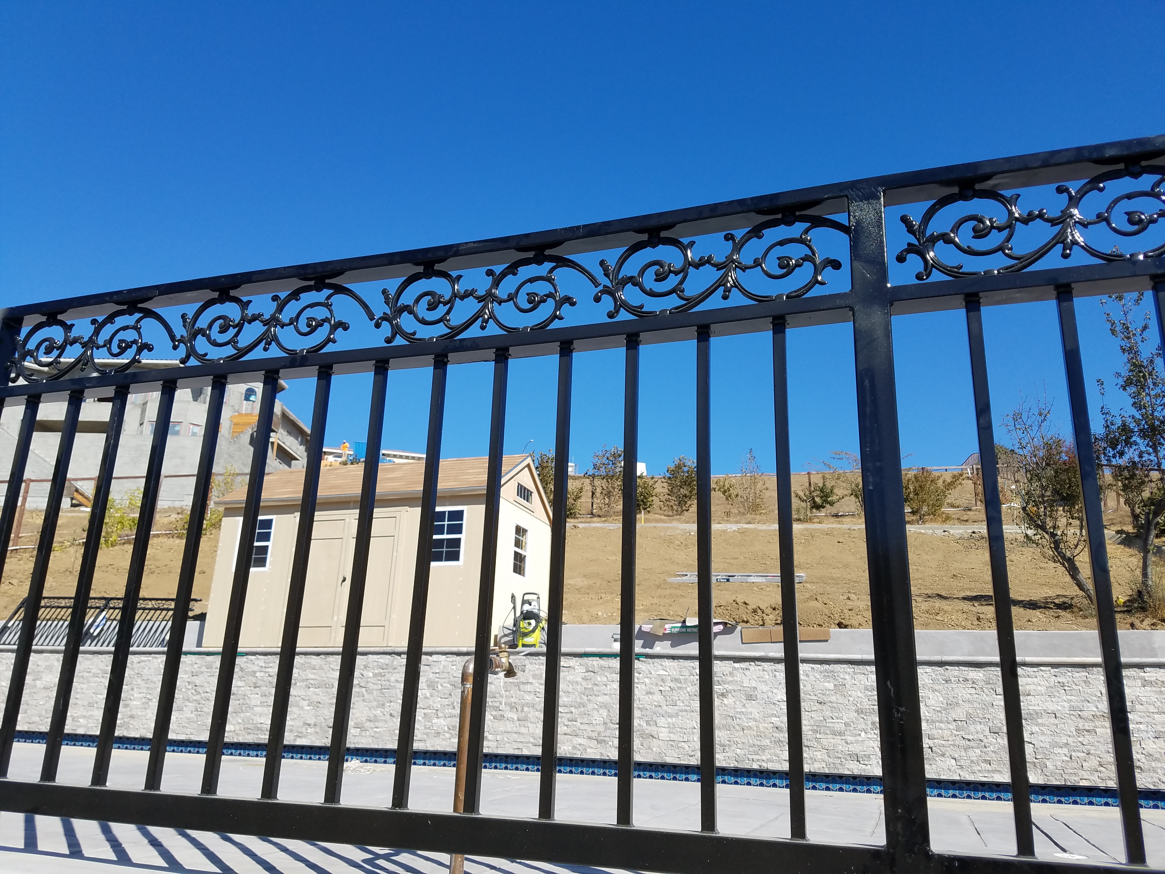

We are having custom-fabricated steel fencing made, with filigrees at the top. $$$. The city inspector said that due to the locking autocover, we would not need an actual pool fence. So the fencing is actually "railings" to prevent people from falling off the hill.
We got a cheap shed from Costco to put on the upper deck. It arrived as a pile of wood. I put it together. The concrete crew expressed amazement that I knew how to build. They asked if I'd ever worked in the trades. I answered that no, I had learned to build with my first house, which I had bought from a reformed alcoholic. Since he couldn't drink, he got nervous and built - at night. He had a good imagination, but not much knowlege or care about building codes. I had to tear out everything he'd done, pull a permit, and build it anew. My wife and I dug the foundation, poured it, did the framing, hung the sheetrock, the siding, building paper, etc etc. Back to the present...
We also indulged in a barrel sauna from Costco. That *also* arrived as a pile of wood. But much nicer wood than the shed.
The auto cover has a keyswitch to open it. I built a pedestal for that keyswitch. It's made of 1/8" thick steel, plasma cut and MIG welded. I also welded a forged steel frog on top.
Here's some pix of the current status:

We have a lot of concrete seating surfaces... BECAUSE the pool builder installed the pipes too high. Oh well. I couldn't visualize how it would turn out, either.

That fence............so pretty!! How did you find the artist that did that for you?

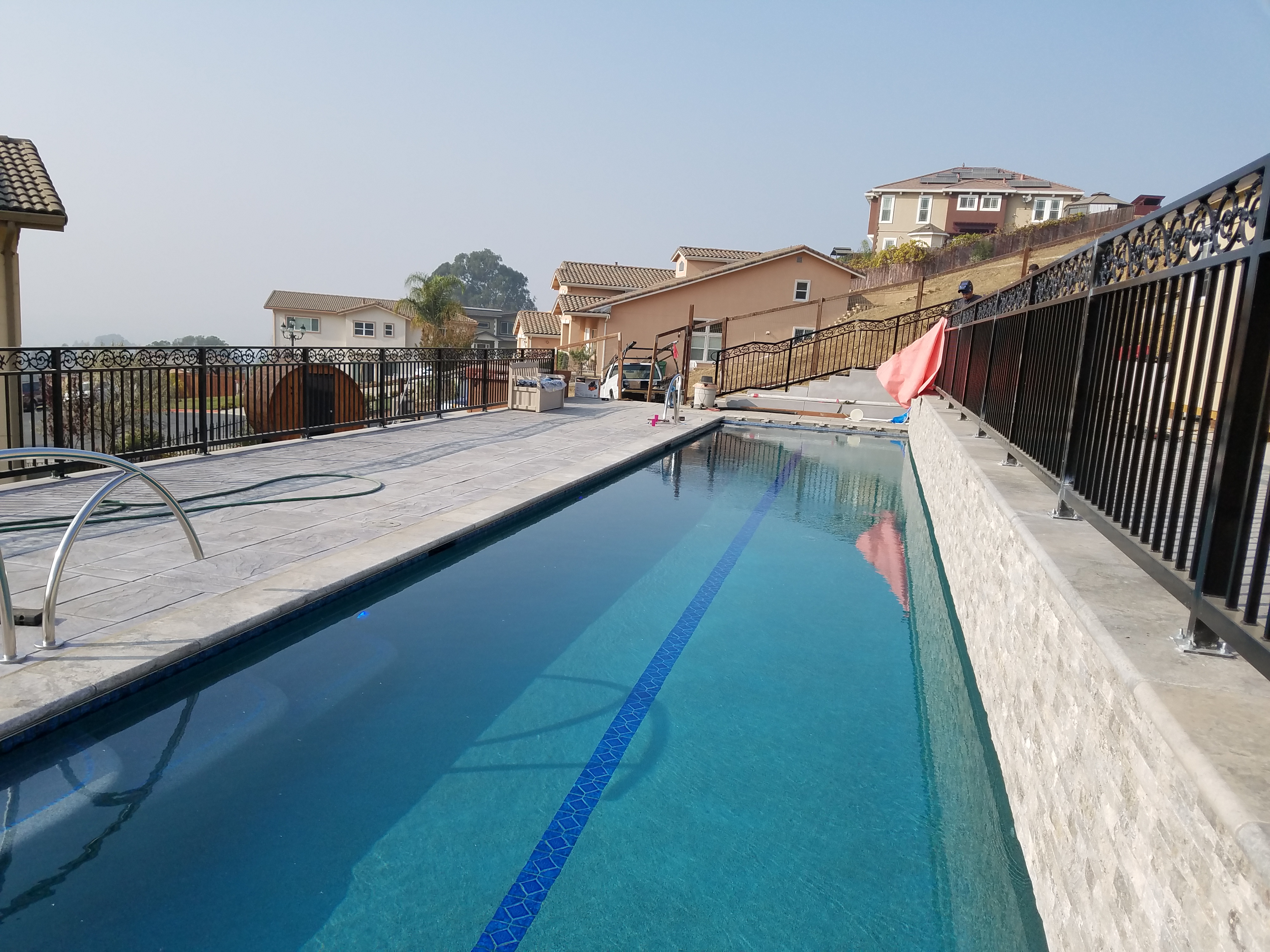

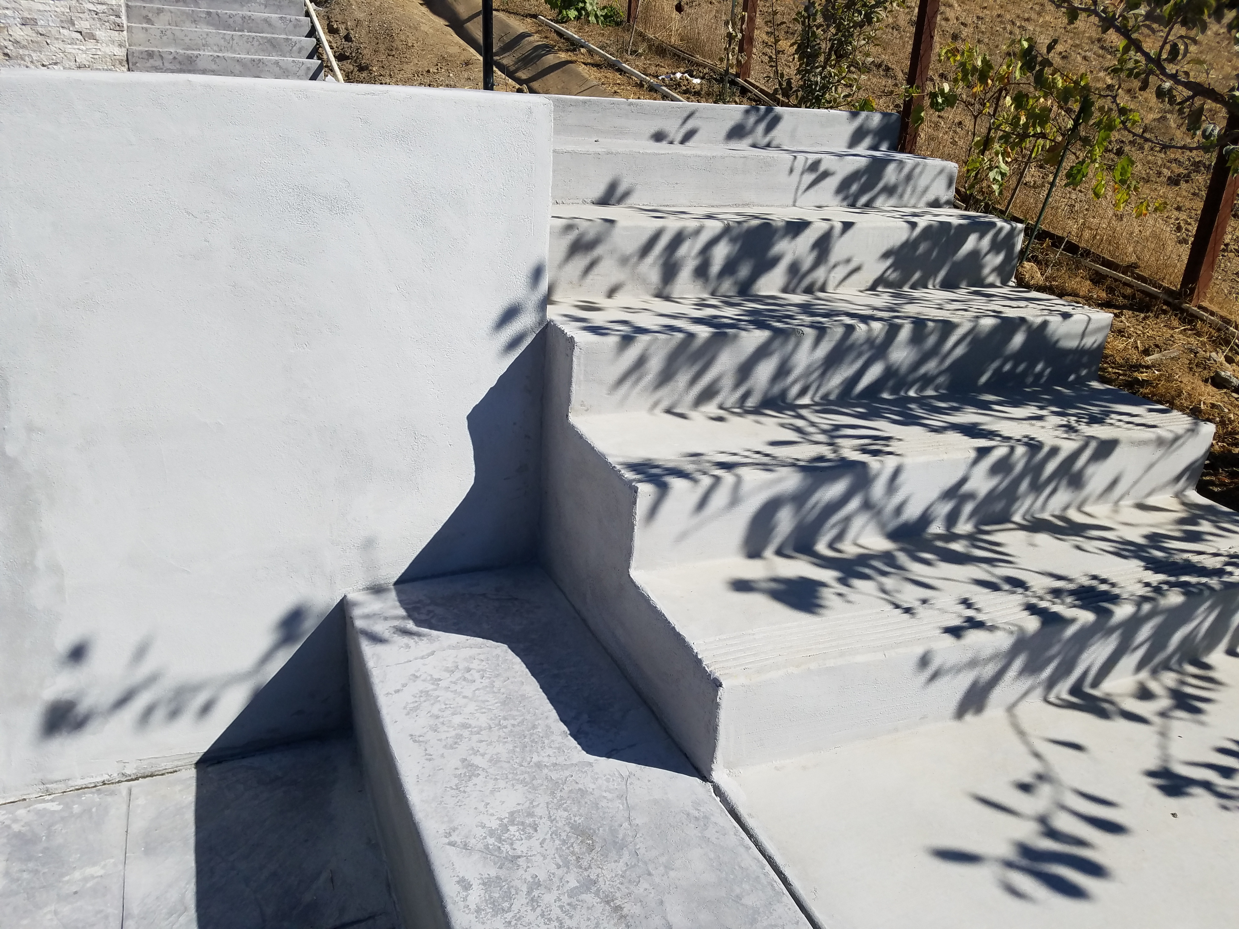

Things are moving right along. Here are some pix from the backyard this morning:
http://www.tr2.com/photos/pool/20181114_082040.jpg
http://www.tr2.com/photos/pool/20181114_082038.jpg
http://www.tr2.com/photos/pool/20181114_082024.jpg
http://www.tr2.com/photos/pool/20181114_082023.jpg
http://www.tr2.com/photos/pool/20181114_082021.jpg
http://www.tr2.com/photos/pool/20181114_081937.jpg
So: They acid wash the surface tomorrow & finish off all the pipes sticking into the pool. Then we fill it with water from multiple hoses, taking care to read the water meter before we start and after we're done. The pool company's startup guy will be here on Friday morning.

LOVE that color! Get your muscles ready to do some brushing!!!

The acid wash guys were out here at 10:00AM, and were finished at 11:30. The pool is filling with three 5/8" garden hoses. The pool startup
guy is supposed to be here at 9:00AM tomorrow morning.
Pool needs to be filled by then, but needs to NOT get full in the middle of the night and then overflow. They advised me to measure the
rate of fill with a tape measure, and make a judgement call.
