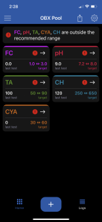

Ok. I got a proper test kit, though it's the K-2005C not the 2006. I also heard back from my contractor and he said they did not add any stabilizer or conditioners to the water and now that I've done a test with the Taylor kit, he's right!
Here are the results of my first test this afternoon:
The pH was still off the charts. It was a glowing hot pink color. The acid demand test took 7 drops to get me to 7.6. I'm going to add some muriatic acid and test pH and TA again in a few hours.

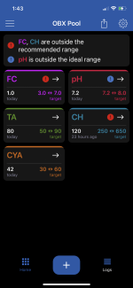

So yesterday I added a half gallon of muriatic acid and went to the store to get some CyA and Liquid Chlorine.
For the CyA, I added 4 lbs. I didn't have an old sock (without holes) and I didn't want to take days to add the granules directly to the skimmer a little at a time, so I ended up dissolving 1 lbs into 3 gallons of near boiling water and mixing into a slurry, then pouring the slurry into a skimmer. It actually worked pretty well, but having to do it 4 times and heating the water on a propane burner each time took forever.
Finally I added 1/4 gallon of 10% bleach. I'm concerned about adding it too fast as the new plaster startup guide here for Acid Wash startups (which I found out is what our builder did) says to raise the CL slowly. If I'm going too slow, please let me know.
At any rate, here's my test results from this afternoon. I didn't re-test CH, but I'll tackle that when I get the rest of the water balanced.
The dashboard doesn't show it, but CC was Zero. I added another quarter gallon of bleach after the test and will retest for FC & CC in about an hour or so.
