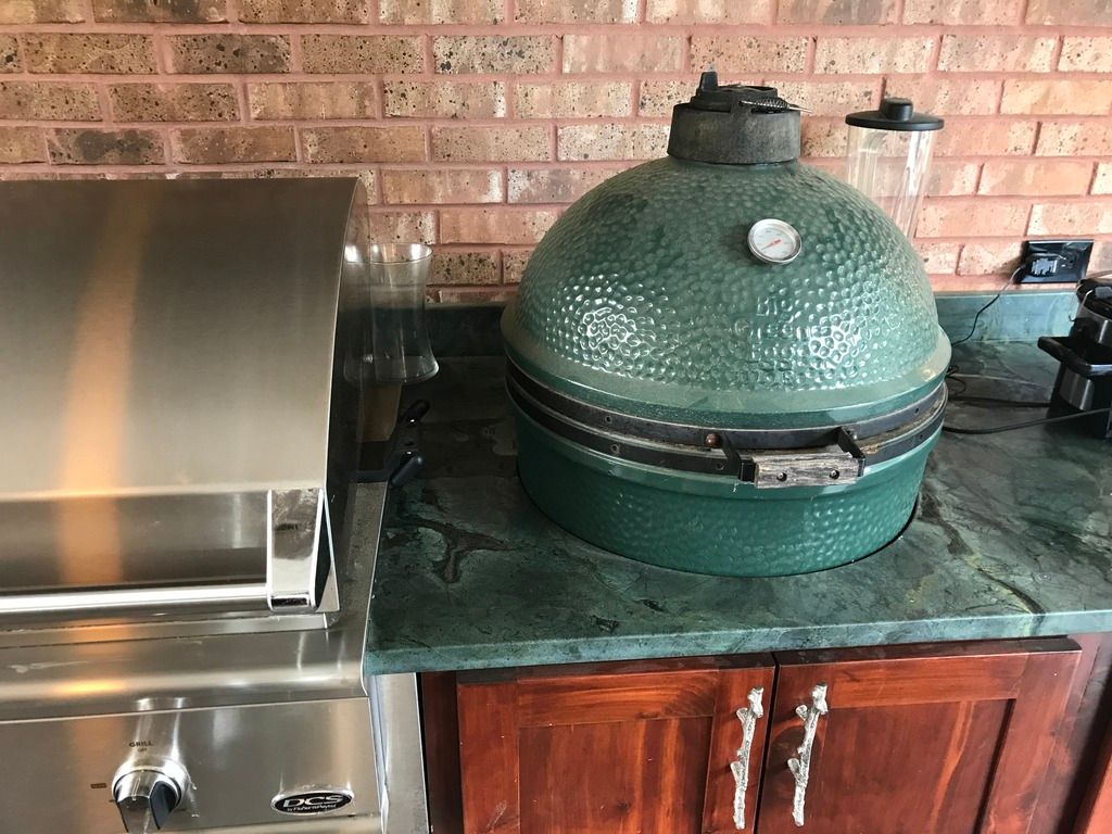

ok i'm stealing ideas. lol cause ur layout of the pool house kitchen is spot on. how deep deep are ur cabinets for the grill? they aren't regular 24" deep cause of the lid for the grill are they?
also how far away is ur egg from the grill and what size egg do you have? how wide is the cabinet for the egg then?

egg is 4-5 inches away from the Grill. Rear counter depth is 30 inches. We have a Large sized egg.
The island counter depth is 36 inches.
Did I answer your questions?

cool! totally. i have mine drawn out at 29 deep so i was right in the ball park. 4-5 inches only is nice. so i know i'm safe there also.

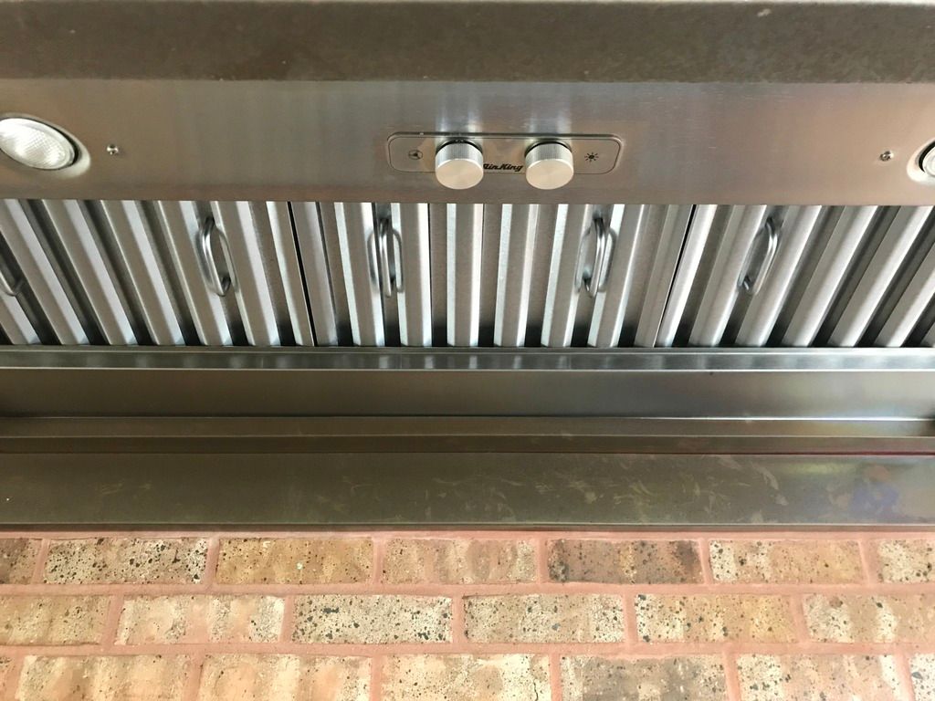

i got to start thinking ventilation now. i would love to copy that copper hood but all i think about was how much it was to do all my copper flashing on my house and can't even imagine going there with time and labor for a custom hood! would love to though. what brand blower did you use? is it just vented up through the roof?

I can get you the brand of the blower. Don't recall exactly. There are two 36" exhaust fans and they vent out of the back of the cabana. When they are running on high you could build a fire and not have and smoke. They are amazing. They are commercial blowers. You could probably do less if you wanted.
The hood is 2x4 and then covered with plywood and then skinned in copper. The hood is @12 ft wide so it's probably more than you need. I think our all in cost was @7k. The cost to do solid copper was 35k. Couldn't justify that and you can't really tell unless you look hard that it isn't.

2 blowers. Ok that makes it much easier to build out. I'll have to get with the guy who did my copper for my house. He does commercial vents for restaurants. He should have some ideas. He doesn't just do copper.
